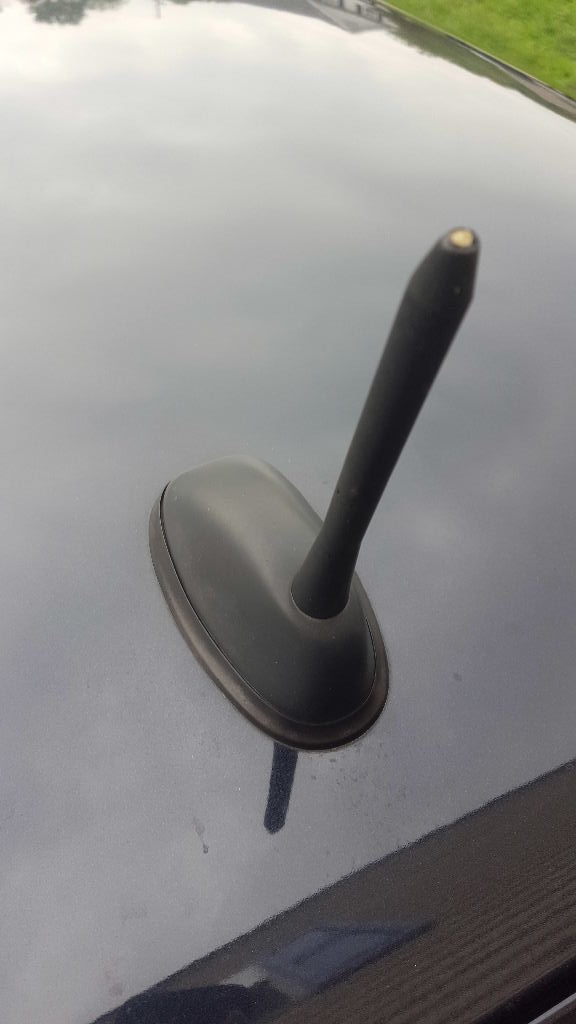

Well .. I think I figured out why the radio gets crappy reception! Please tell me this is an easy fix.
Yup...that is a non-oem short antenna...
Like I stated a few posts back...see if you can install a nice tall OEM one...will give you 50+ miles of FM.
Shorty's are not so good..as you know.
OEM is a rubber "ducky" style..about a foot tall....part solid, part flexible to get the CORRECT LENGTH electrically be go a good FM antenna.

Non OEM alright - looks to me like the top got clipped off.

That was the tall, OEM antenna. It looks like someone decided to save some $$ and just cut it at the transition for a DIY shorty.

That's my thoughts exactly.
