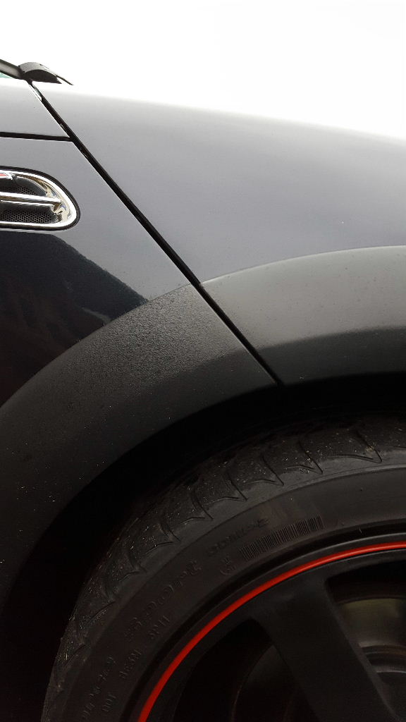

Images 001-004: The hood (bonnet). Is it just me or does this hood not line up properly?

Hood doesn't look very straight to me either.... The last two pics look like a speaker amplifier. ( looked up the numbers on Google) I figured that is what it is because that is where the stock Harmon/Kardon amplifier goes if the vehicle is equipped with the H/K speaker system like mine. Mine has the vents as well but I'm not sure what they are...

I've seen those vents in every r53 I've been in, no idea what they're for, kinda like the button in the middle of the dash.

This might sound silly - but how would I 'align' the hood?

Your bonnet looks OK at the top where it meets the cowl. Mine is like yours too, but mine has been in contact with things unknown by the PO. The wheel arches have a little adjustment to them so you could try that. There may be a little adjustment possible where the hood meets the rubber rests at the front and you may be able to move the hinges a little.

Your bonnet looks exactly like mine with all the gaps. Like Aspen mentioned, the vents above the rear view mirror is for the factory bluetooth kit, and the ones above the rear seats are for the motion detector( if car is equipped with the Alarm option).

Your bonnet looks like mine also. It's been that way since delivery nearly ten years ago. It appears as normal as all the others. I do however keep the bonnet latching mechanisms clean and dry lubed to prevent binding and assuring proper closing. Recently I noticed water in the boot battery compartment after a heavy rain. Having read that the antenna mast and third brake may be the source of the leak, I sealed both externally with a clear latex caulk and sofar no problems. A simple fix. Congrats on your R53. I plan to keep ours until they take my keys away.

The vent in the back and the roof is for the OEM alarm... All cars got it, installed it not...
The cover in the front was for the Bluetooth mic...same story.
Alignment of the bumper...EVERYTIME you take it off to put the car into service mode, you can adjust it....

Great to hear. Where are the adjustments in the arches? Would it help .. or should I leave it alone.

Your bonnet looks like mine also. It's been that way since delivery nearly ten years ago. It appears as normal as all the others. I do however keep the bonnet latching mechanisms clean and dry lubed to prevent binding and assuring proper closing. Recently I noticed water in the boot battery compartment after a heavy rain. Having read that the antenna mast and third brake may be the source of the leak, I sealed both externally with a clear latex caulk and so far no problems. A simple fix. Congrats on your R53. I plan to keep ours until they take my keys away.
Great x3 to hear about the hood. I will review the latch and clean up if needed - although it's really clean already. I have been watching the battery are in the boot - and no moisture yet. Thanks for the congrats. . If it works out, I'll have him til they take my keys too.

The arches attach to the bonnet. There are some fasteners that you can see when you open the hood. I think there is a little movement available there. If not enough you could oval out the holes to get the correct amount.

There is an adjustment for the bumper. I saw it in a Youtube video of guys putting the mini in service mode
