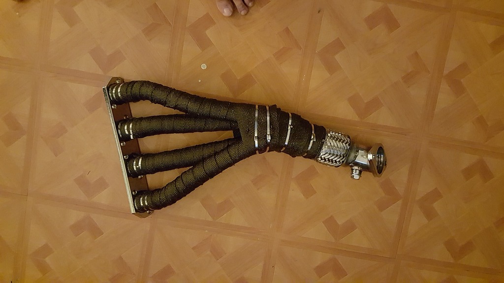

Thank you guys for all the response. I did end up ordering the headers with the flex pipe and 90 degree 02 bung, paid 117 and change on good ol egay. Due to deliver Saturday. No work this weekend so I'll get the install done and report back.
Fingers crossed they fit well
I'll probably end up welding the cracks in my obx headers, so if anyone is interested and wants to pick up some headers and a magnaflow cat on the cheap let me know
Might even be the low low price of FREE beings as I wouldn't want to pay a dime for repaired headers.
All I'd ask for is a shipping label!
Old Apr 23, 2016 | 07:11 PM
JCWCabrio's Avatar
JCWCabrio
Joined: Dec 2015
Posts: 135
Likes: 11
Okay so they came in. Everything fits nicely. Installation was a pain because of the flex joint in place (it's loooong). This would not be a problem with a lift. If you're doing it in your garage with jacks and jackstands get your car as high as possible. Downstream o2 bung was not welded in the proper position. You will need the 90 degree adapter that I'm so glad I bought otherwise the sensor isn't going in. Flanges lined up PERFECT thank god (and they were Flat according to my straight edge). Upstream o2 sensor connector will need to be taken from its little circular holder to give you a little more length in wire to reach, no biggie.
BE SURE YOU TAKE OUT ALL HEAT SHIELDS UNDER COOLANT RESIVOIR AND THE OTHER SMALLER ONE BY DOWNSTREAM CAT.
I cannot stress this enough because the headers will NOT fit without the shields gone. Heat will be an issue there so to combat that I used exhaust wrap.
The sound is OK for now. Gaskets need to set and the pipe needs to get broken in (carbon on the inside walls) before I can give any real feedback on sound.
For the price I would buy these again.
I would recommend installing on a hoist for easier access.
As far as power goes, as expected, there is more pull at top end. You will lose some bottom end as these are a 4-1 header with NO cat and NO resonator.
Hopefully someone gets some help from this thread if they are planning on purchasing these.
Here's a pic of the set I received:
Sorry, I didn't take any pics during installation.
Rock on fellow enthusiasts

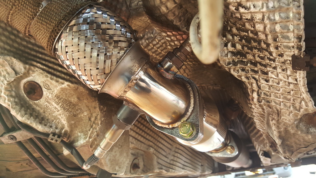

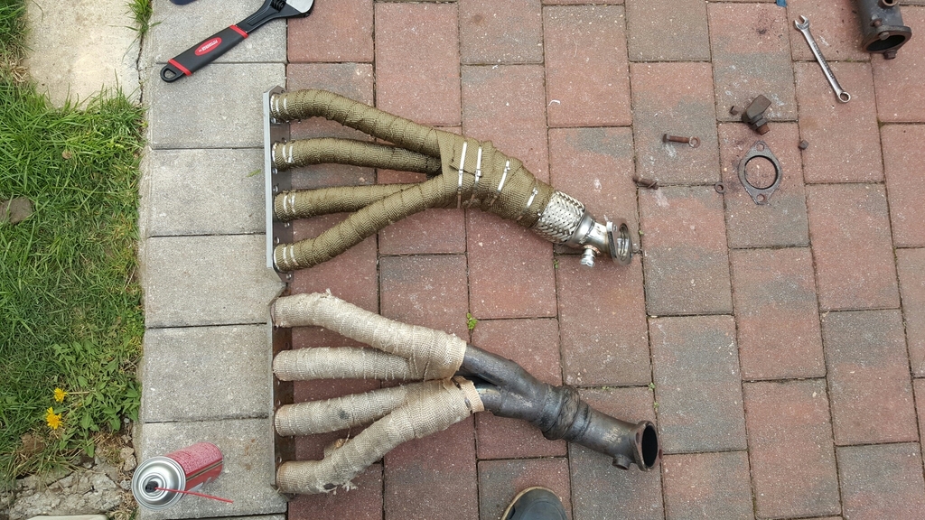

HaveATank's Avatar
HaveATank
Joined: Jul 2015
Posts: 460
It really depends how the exhaust lines up at the flanges. I personally just double them and that does it. no more leaks.
This are the once i got Installed it yesterday

Old and new
