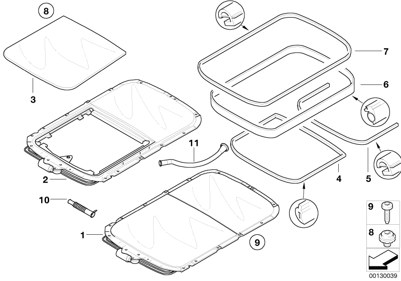

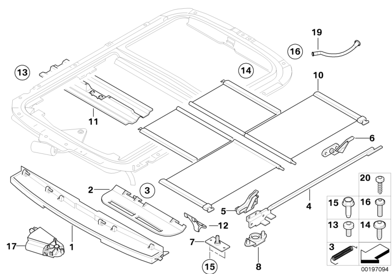

Have you looked at the tracks to make sure it's not off a bit on one side? There's a cassette and cable. The "cassette" is a complete assembly, the "cable" is what drives the mechanism. Check those as well.
I believe #2 is the complete cassette:
#17 is the module:
Just check out all the components first to make sure something isn't off.
#17 is the module:
