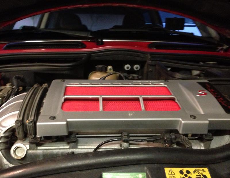

I need your help. I have been searching RealOEM for the front mounting hardware of the intercooler cover on an 04 R53 JCW. I have gone to the dealer and what they give me does not match what is on the car. It looks like I have a really long nut/spacer that is missing. Can someone tell me or post a photo of the front mounting hardware so I know what I'm looking for?

I could not find that diagram anywhere. My R53 was built 09/03. If you look at front right corner of my cover you see the black bolt that goes down through the top. If you look close to the bottom there is a silver tall looking "nut" that no one seems to know anything about. I need the bolt and nut. I'm wondering if the previous owner lost the hardware and just came up with a solution. Thanks for the help!

Thank you guys for the help!!! I ended up having a broken bracket and missing screw. Both are on order and will be here Friday.

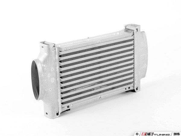

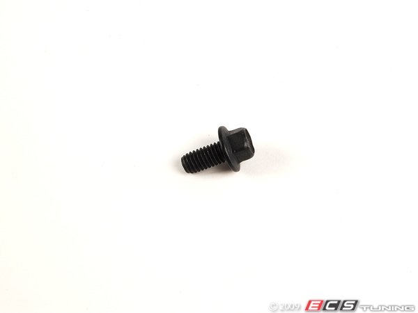

That long tube bolt (silver ) comes on the intercooler: Not a separate part. You can see it at the top of the intercooler bracket.
http://www.ecstuning.com/Search/SiteSearch/11651515368/
Number 3 is the support brackets: 17517511947
http://www.ecstuning.com/Search/SiteSearch/17517511947/
#4 is the bottom bracket with a bonded nut. 17517515798
http://www.ecstuning.com/Search/SiteSearch/17517515798/
#6 is that long bolt. 17517552372
http://www.ecstuning.com/Search/SiteSearch/17517552372/ES39173/
#7 07130782486
http://www.ecstuning.com/Search/SiteSearch/07130782486/
Hope that helps for reference in the future.
