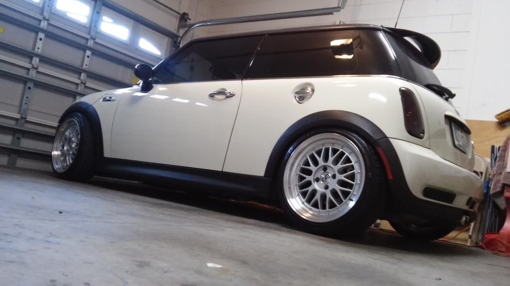

This is what I was looking for. It honestly feels like im driving stock with runflats

Does that rub? Looks like it might but I don't know how much give your suspension has... also.. you aren't running the spacers right?

So far its not rubbing, but thats because I removed the fenders and sanded inner part of them. No spacers. And as of ride height ill get back at you to give you a accurate answer.
