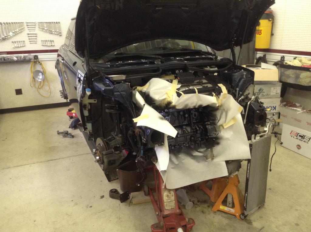

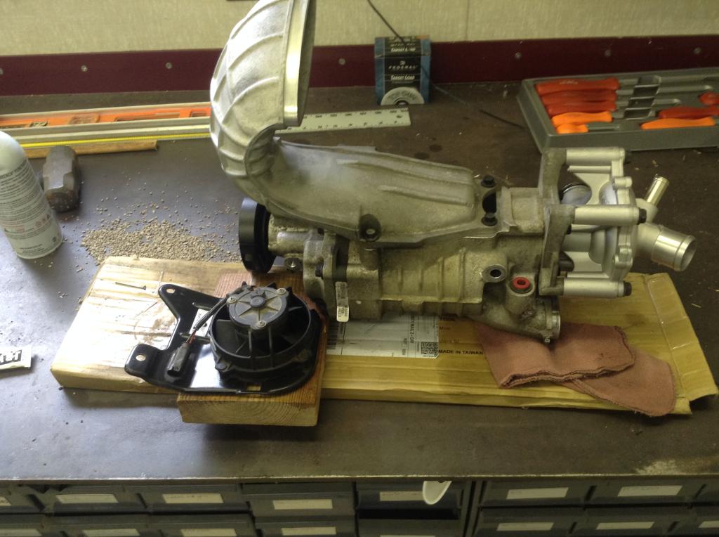

Got some pictures of my tear down progress today to service the super charger and clean under all the trim.

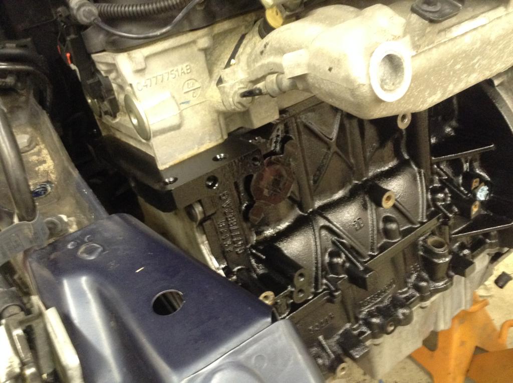

Got an update, the supercharger oil is changed and the 17% pulley is now put on. while I had the supercharger off the motor I replaced all the gaskets on the front of the motor and the oil pan gasket to stop the leaking oil and slight coolant leak and replaced the water pump. I also have the engine mounts all replaced with Vibratecnics mounts and a set of gearbox proflex bushings. I picked up some r90 anthracite wheels to put on, and found rear GP bumper inserts I am going to install. I ordered my GTT chassis braces this week, and I also ordered a full set of Willwood 13"/11.75" brake kit from TCE. Here are pictures of the painted block and other progress currently.

Got some more done again, the entire front of the motor bolted and torqued back on, replaced to valve cover gasket and flushed the valve system with fresh oil, got my first order of parts from GTT and installed the boot brace and catch can, and got all my oem parts and the r56 aero side skirts I am going to fit.

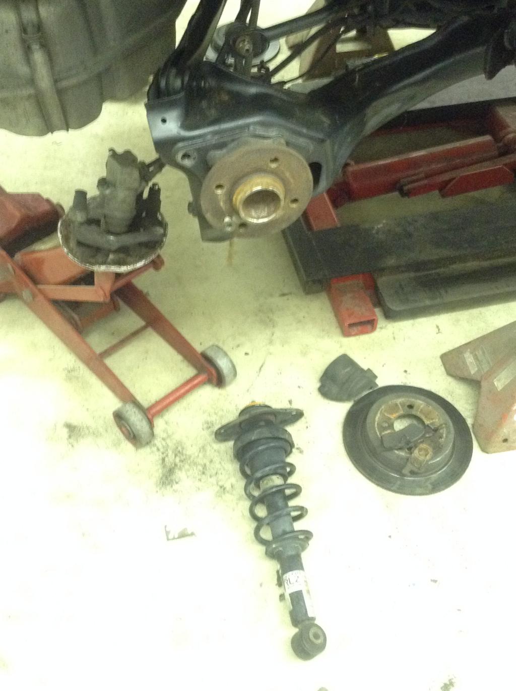

So am getting a lot of work done on the MINI this week as I have some extra time to work on it. I got it on jack stands so I could used the lift to lower the front subframe, and took the control arms off to change the ball joints and bushing, and am changing all the other front bushings to power flex at the same time. I am also going to powerdercoat the arms, sway bar, and subframe to protect more against rust. I will be putting on a new power steering pump also. I did some work in the rear pulling the rear shocks and brakes off prepping to put on the Koni FSD's and the Wilwood BBK.

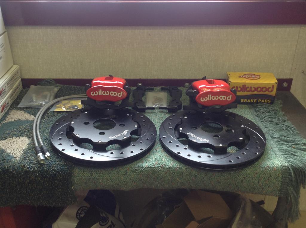

Yeah trying to make it last and add a little bite at the same time. Here is the update for this afternoon..... I got the the hubs painted with heat resistant paint, got the front subframe stripped of parts so it can go to powder next week, and got the rear Wilwood BBK out and started installing, the driver's side is shimmed now just have to do the passenger side.

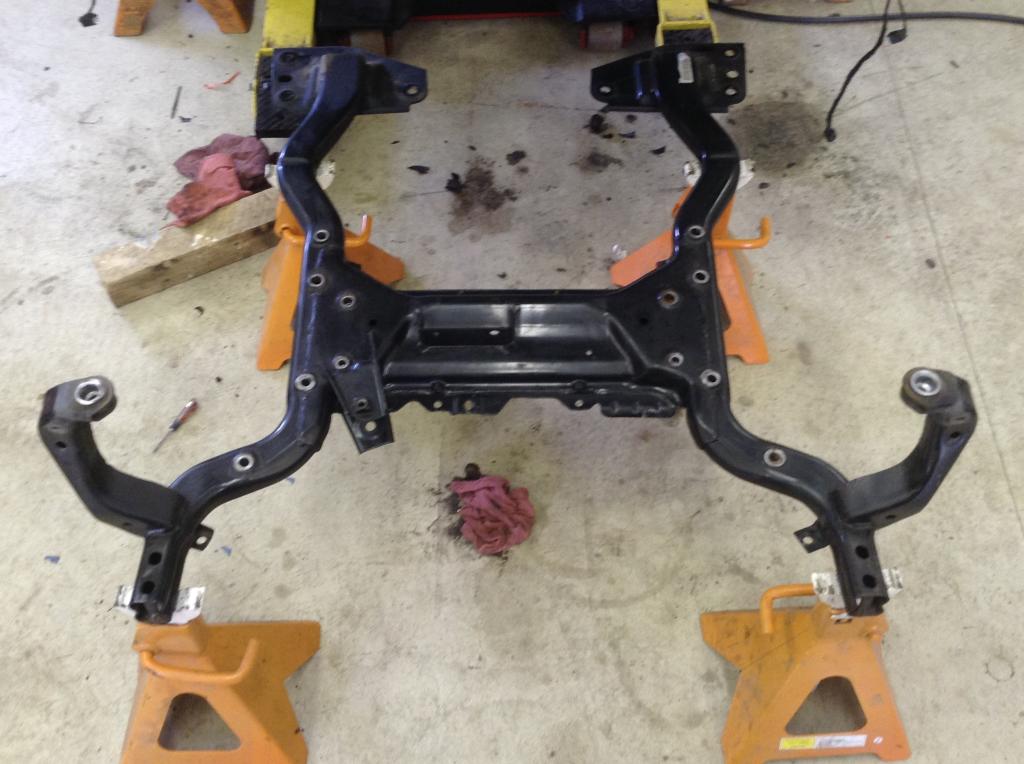

Sorry for no posts to those who are following the thread, had to take a break from the mini as school projects pile up at the end of the semester, I have my subframe back from powder, so when I am done with my finals then its back to the mini every night.
