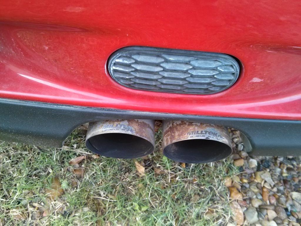

Got the exhaust wrong, milltek exhaust. I will have to see if the full exhaust or just the cat back tomorrow.

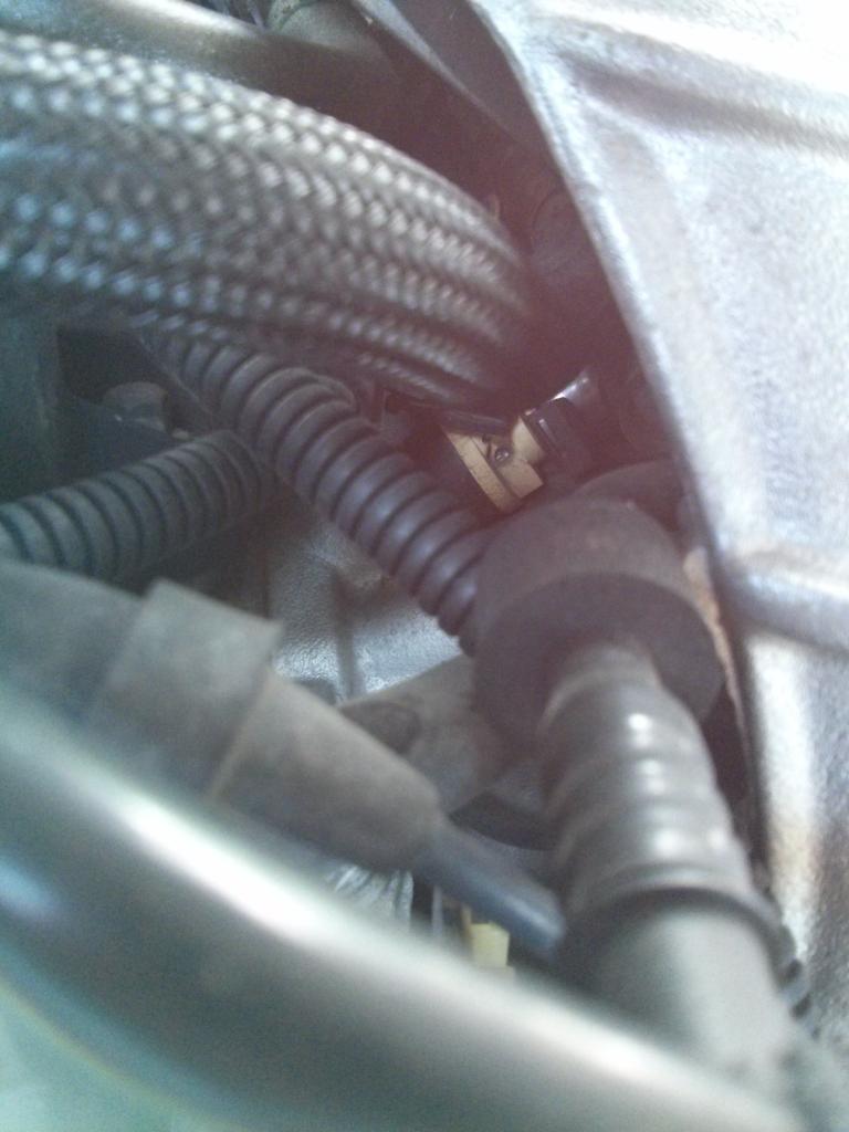

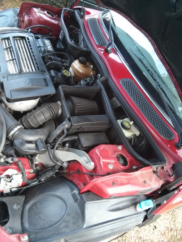

OK, air filter box, pulley, exhaust, exhaust manifold, fuel injector are all in those shots

Stock header and injectors. Aftermarket intake of some sort, pulley,and catback. Those hoses on your passenger side near the strut tower kinda look like they might lead to a catch can of sorts, but its hard to say from that picture.

Looks like you have the most common mods; S/C pulley, cat back exhaust, and cold air intake. I would suspect no ECU tune due to stock injectors but I could be wrong.
It is hard to tell from the photos if the car has been lowered (aftermarket springs). Aftermarket springs are usually some other color than black.
Another common suspension mod is a larger and adjustable rear sway bar. If it is adjustable you will see two or three holes where the end of the bar connects to the end links (which connect to the strut).
