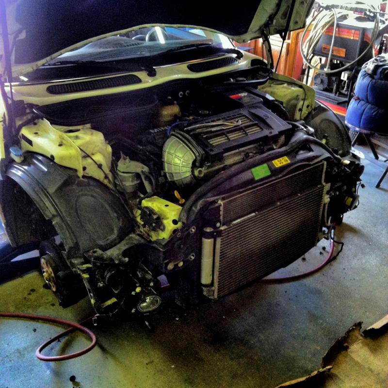

So you may ask whats there to “revive” ? Well now the car has 115K and things just aren’t the same. It just doesn’t have the kick that it use to. I’m sure that the supercharger gears must be worn, I’ve yet to do a compression test as I'm worried about the results. The clutch amazingly still grabs fine but the pedal feel has changed. The car just feels tired, which is sad because the rest of the car is still in very good shape.

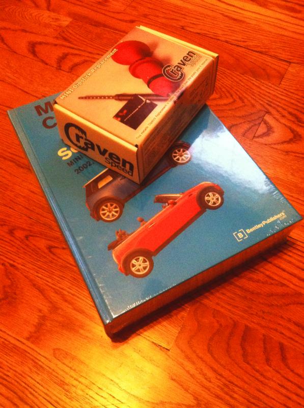

With it came a Craven Speed oil dipstick. How does that help with the rebuild you ask? It doesn't. But it does fix this little issue with the stock one. And yes thats duct tape, Im not usually that ghetto with fixing things, but you do what you have to to get by
What a great little product, and I highly suggest it. Works great, no fiddling around getting the stock one lined up, and most importantly, the oil level marks are WAY easier to read.

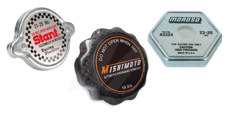

The harder choice really is what cap to run. Many on here have had to get fairly high pressure caps so that they don't leak. Canton suggest a Stant cap, Moroso makes a good selection of different caps at a slightly lower price. Id really like to get one from Mishimoto but they don't make a cap with a high enough rating (that I've found anyway)
