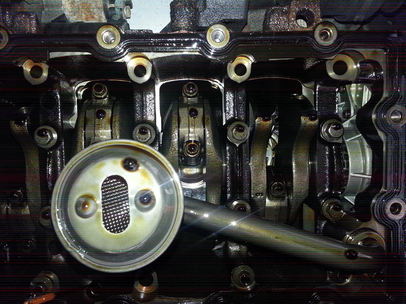

One day i parked my 2002 r53 in my driveway. After moving the car I notice a spot of oil, which I later investigated and thought it was coming from the back side of the oil pan. I ordered a new oil pan gasket. Removed the oil pan to replace gasket. After removing the oil pan I found six bolts from the support ladder that walked its way off. There were no washers with the bolts that I found. However, when I placed an order for new bolts from the dealership, I was told that I would receive washers as well the bolts. I'm assuming that the assembler inadvertently forgot to install the washers with the bolts during assembly. The other four remaining bolts are also loose. I am just passing the word of accidental discovery and experience. I would like to know if anyone experienced this problem. I am the original owner car has 70k.

Pics of Bolts from Support Ladder that ended up in oil pan
These are the pictures of the support ladder where the bolts backed out into the oil pan from my 2002 R53 with 70k.

I'm not familiar with the term "support ladder", can you explain. Thanks!

oof!
Those are main bolts.. well. sort of.
Those are the bolts that hold the bottom part of the block to the main part of the block

This lower section?
That's crazy.

Wow thats a pretty big screw up not to tighten those at the factory!
