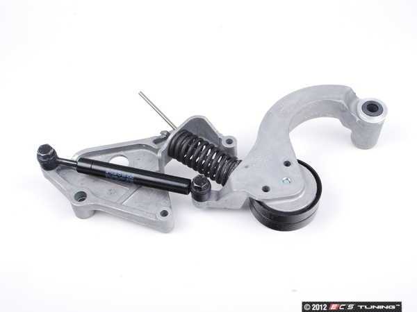

If it's rotational at right bottom side (aka: Front of Engine ) while engine running/parked, could be a few different things....
The Hydraulic Belt Tensioner. 1st make sure the belt isn't just worn out. Slack in the belt will make the metals of the assembly rattle some creating somewhat of you describe. Should be at least 3/4 of the top hole showing in the metal strip running through the top of the spring.
If belt is good, could be one of the bushings at either end of the hydraulic tensioner has worn out. THAT will rattle for sure. If so, only comes as complete assembly.

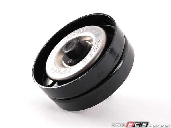

I have also seen instances where it was either the idler pulley...
http://www.ecstuning.com/Mini-2004-C...lleys/ES21587/
