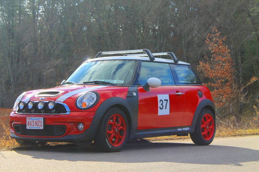

Could you share what kind of driving lights and brackets you have installed?
I'm wondering on the brackets whether it would be possible to position them with a bigger gap in the middle instead of evenly spacing them? (one of TomFarin's images in the OP shows this)

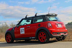

Roof Rack
I indicated earlier I wanted to go with the factory roof rack. So I called my dealer. $245 for parts. $345 for labor. Over $600 including the tax. I've heard worse quotes so I should feel blessed, I guess. The most galling part is MINI wants $40 for installation tools. When the dealer is installing the parts! I thought one of the reasons you went to a dealer for installation is so you didn't have to buy tools. The primary installation tool is a hole saw bit. Yikes, $40 for a single bit. Must be made from gold.
So I went to the aftermarket vendors. One has the rack and installation hardware for around $200. But not the tools. He suggested i go to the hardware store for the hole saw bit. It is scary enough to be drilling holes in a MINI roof without using the tools designed to do the job.
Yes I checked out Yakima, Thule, and Inno. They don't have the look I want and could easily damage the roof rails. But there are no holes to drill. I'm still agonizing over this one.

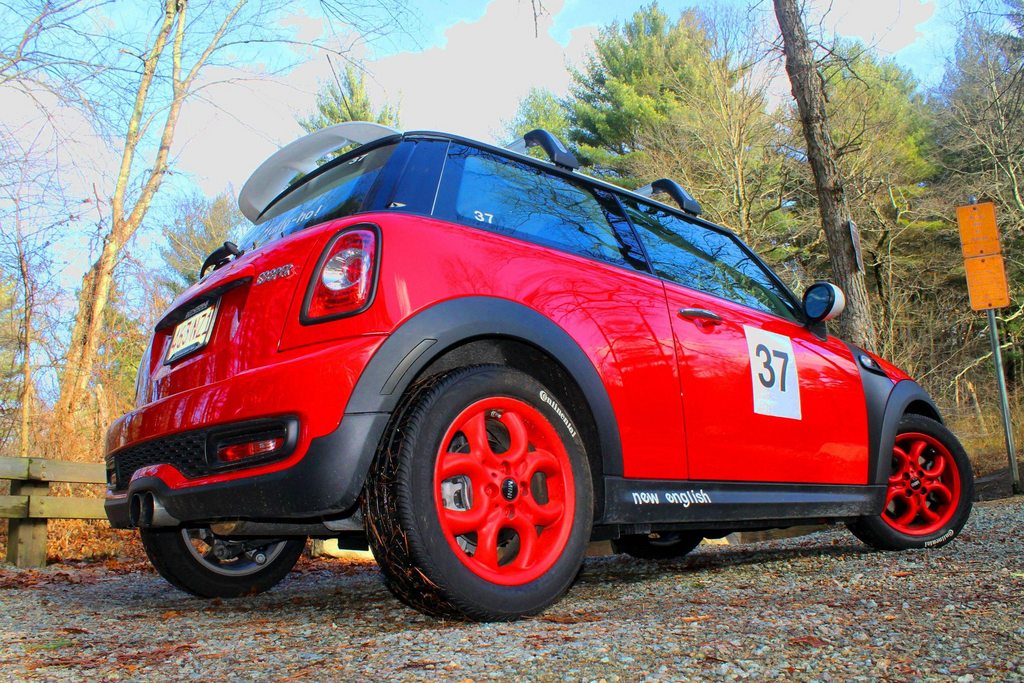

Wheels and Tires
I plan to go with the Michelin Pilot Sport A/S 3's. They seem to be near a summer tire in performance in an all-season tire. I was already to order them from TireRack but decided to check availability of the Rota RB wheels in Hyperblack. The primarily supplier of these wheels to the MINI community won't have them until some time in July.

3. I found the Rota RBs on line late last night (eBay) and did a "Buy it Now." I should have them within a week. I'm waiting for a tire/wheel deal from the vendor. If they don't get back to me today, I'll order the tires from TireRack and have them mounted locally.
I decided to go with 16" rather than 17" wheels for three reasons.
1. They are cheaper - wheels, tires and mounting.
2. We live in pothole country (Wisconsin). Last year on the way back from the Dragon on my wife's 2011 with 17" wheels, we rolled over a pothole on the Illinois Tollway at 70 mph. It took out two wheels and one tire. I'd like to have a little more cushon between the wheel rim and the tread of the tire. I may give up a bit of handling but hopefully the tires and a rear sway bar will more than compensate.
3. Classic Minis had small wheels and big tires. The original Mini had 9" wheels.

the bulbs are 100W landing lights off a Cessna.....the light housing are a standard PAR36 light housing, i think i bought mine at Harbor freight, they sell them as tractor lights....i just swapped the bulbs out.

A copy if the installation manual for the factory brackets is at the OutMotoring web site. I've read it front-to-back 3-4 times. Templates are provided. In installing, you drill a small hole at the points indicated by the template. Then you check to see how close to center of the threaded holes in the roof frame you are. You go to progressively larger holes until your hole is the same size as the threaded holes in the roof frame. If the hole is off center, you need to use something like a Dremelwith a routing bit to correct the problem.
You then screw a threaded rod into the hole. The factory hole saw fits around the threaded rod and further routes out the hole to accept the post the rack mounts to. That part is larger in diameter than the threaded hole in the roof frame. The hole saw fits over the threaded rod and further expands the hole, insuring that the hole's diameter is the same distance all the way around from the threaded rod.
That's the part that scares me about using hardware store parts. How do I locate a hole saw bit that has the same inside diameter of the threaded post and the thickness needed to further expand the hole without oversizing the hole and creating a water problem?
The top tech at my MINI store has installed 5-6 of these roof racks. He tells me the initial holes are never on center. He says it takes him 4-5 hours to install a roof rack. He is a very exact guy. So I said, "If I'm being charged three hours for installation, you must think its a pretty good deal." He agreed. I said, "you have the job."
I don't need to be screwing up my roof.
As for Thule and Yakima, both racks are fine for their intended purpose -- mounting bike racks, kayak racks, ski racks, etc. They are limited to under 100 pounds, however, and if you over tighten you can damage the plastic drip rails.
I want a look that is reminiscent of the roof racks on the 60s factory rally cars. Of course, those were 1 piece rack/basket combinations. What I like about the factory rack is that its width was sized for the MINI. So if I install a basket on top, there won't be these rods hanging over the edges. Yet the factory rack accepts Thule and Yakima accessories (including my Thule Kayak racks) and will handle 160 pounds.
Yes, posts will stick up when the cross bars are removed. But as long as I can address the wind noise issue, I won't be removing the cross bars.
