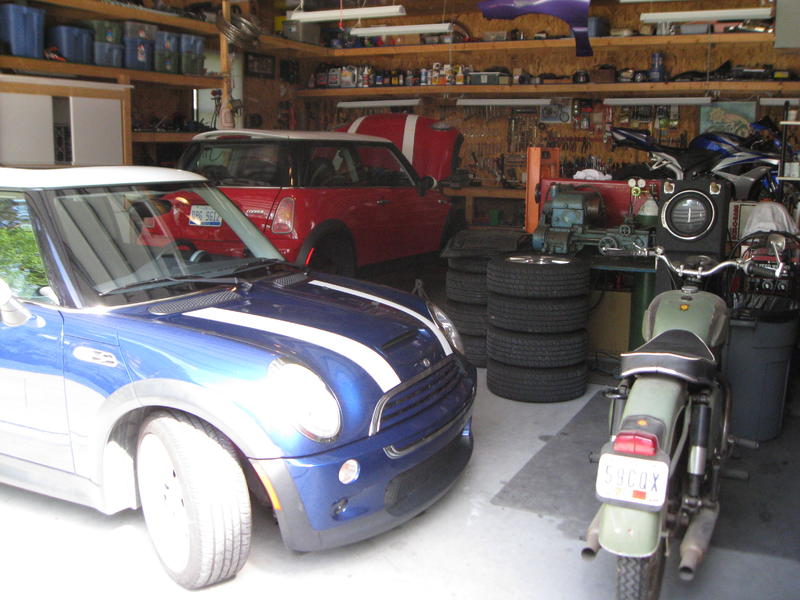

Well, not over the loss of Green but decided to help the issue by buying a replacement. Red is up on stands waiting for a new clutch, etc. and is now sharing the workshop with Blue (could not bring myself to get another green one)!

Old May 26, 2014 | 05:43 PM

Wow!! That was fast!!
Bet green is still smoking....and the replacement is in the garage!!
Congrats on finding a replacement so fast!!

Ah, had my eye on this one for a couple weeks now, would officially had a fleet of 2004 MCS's had Green not self destructed. Blue needs a new tensioner, idler pulley and belt as well as new spark plug tube seals but beyond that all is good, Officially registered a complaint with the NHTSA, not expecting anything to come of it but need to keep the statistics on the level. BTW I did have comp insurance put on the Blue Red and White today so lesson learned!
