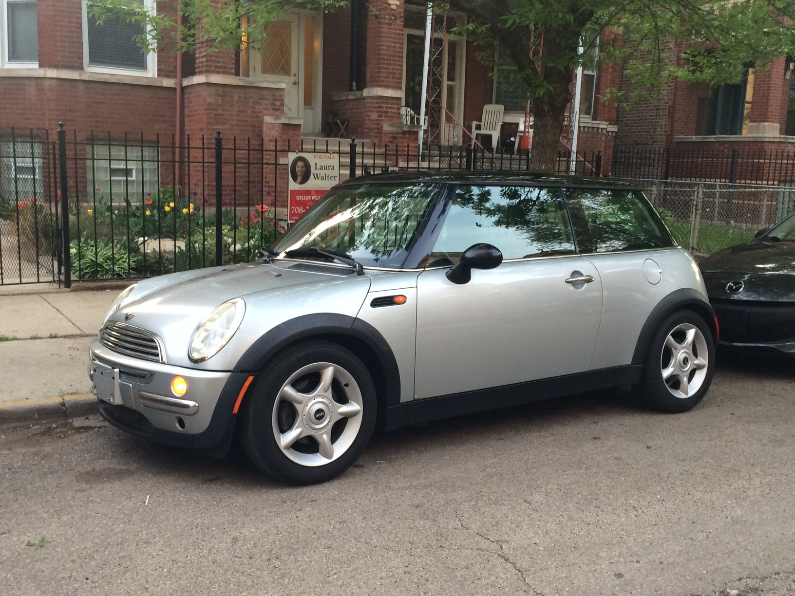

Hi Everyone. Just bought an 04 Mini Cooper with 103K on the clock, 5 spd manual. Its very clean, got a good deal on it. Here's two pics so far.
