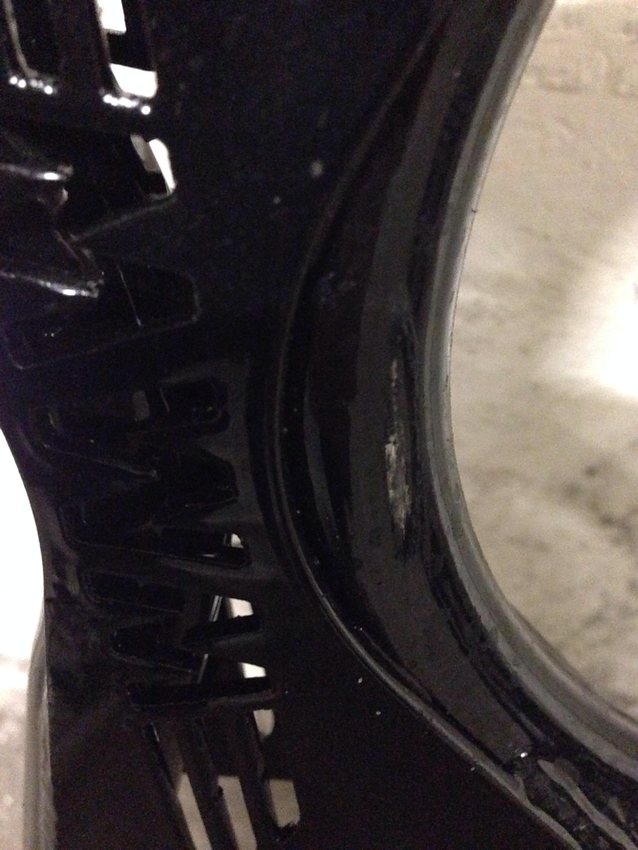

Whelp, I found the source of the problem:
This is with brand new engine, trans and torque mounts. Got under the car and inspected every mount on the exhaust, and everything is in great shape. I would need at least another inch of clearance... and i'm not about to put an inch of spacers on those chassis bolts just to make this work. Doesn't seem like everyone has this problem, but judging by the posts I've seen online, it's not rare either.
I'm going to contact WMW and see if I can get a return on the brace.
Ok, didn't realize everyone called the two hangars "middle" and "rear". Regardless, both were in great shape.
I'll need about an inch because the brace is leaning about 1/4 inch into the cat. On heavy accel on up hills, there's still a good half inch or so of movement downward due to engine torque, even with brand new, stiffer than oem mounts.
Add to that the fact that, because of the angled front mounting point, you can only spacer the rears without fit issues ( making 1 inch of spacer lower it only 1/2 inch at the point of contact) and there you have it.
The bummer is that, based on posts in this and other forums (see above) this doesn't appear to be an isolated problem. I really do want this thing to fit, as it does improve stiffness, but it's not going to happen in my case.
If the cross section of the brace moved rearward by a couple inches to clear the bulky cat, then that might be another option for WMW to consider for future braces.

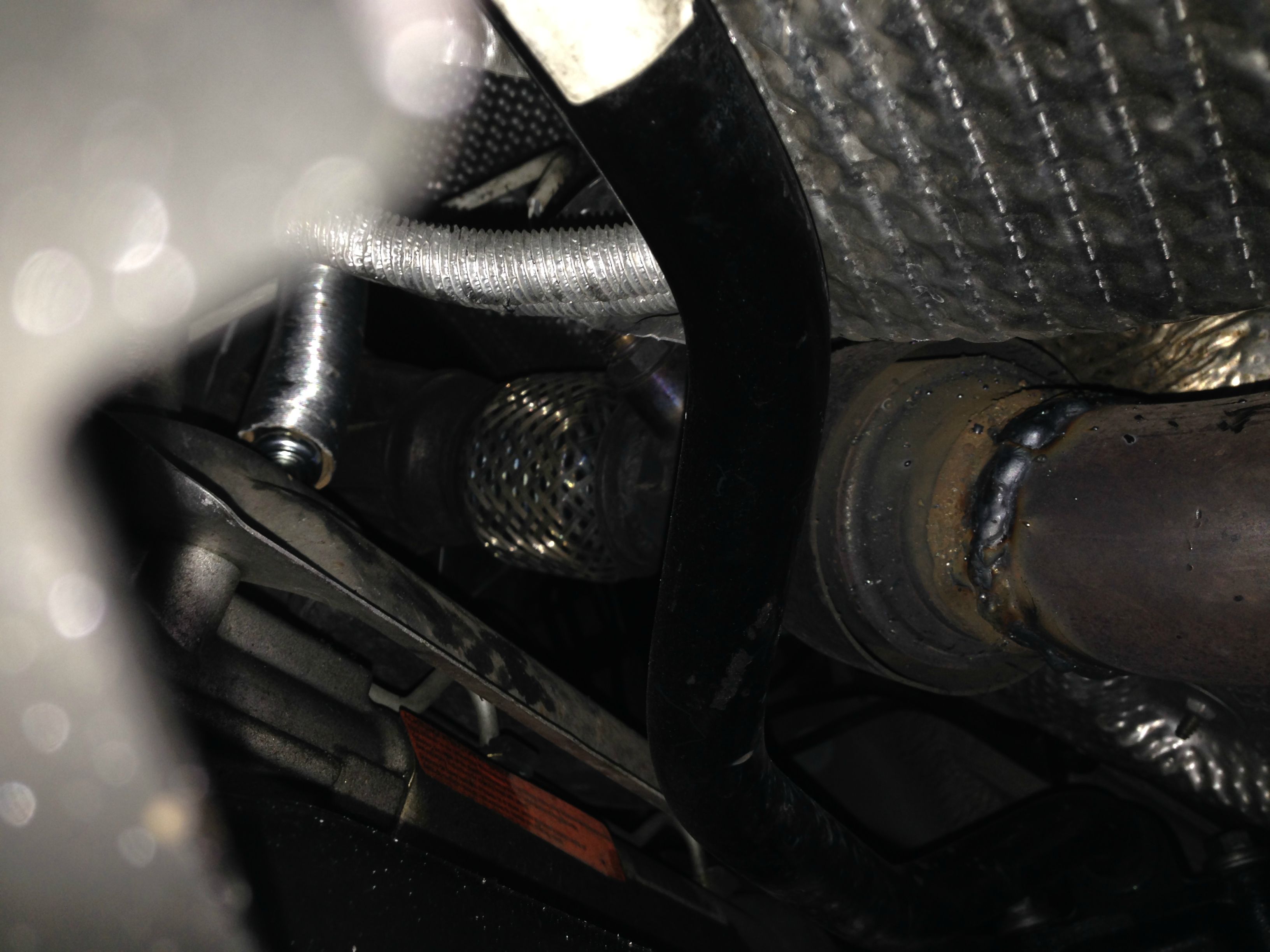

Annnd FIXED!
For anyone having the same problem:
1) The brace is fine; it's the the stock mounts that went bad.
2) Over time, the excess engine movement slowly stretched out the exhaust's flex joint, causing the cat to sit nearly two inches lower than when new.
So the fix is:
1) Replace the crap stock mounts
2) either replace the flex joint (more money), or just cut the downpipe back a bit and reweld (less money).
Here are pics of the stretched flex joint, reweld, and new clearance. BTW, big difference in stiffness. Get this brace already!
So the fix is:
