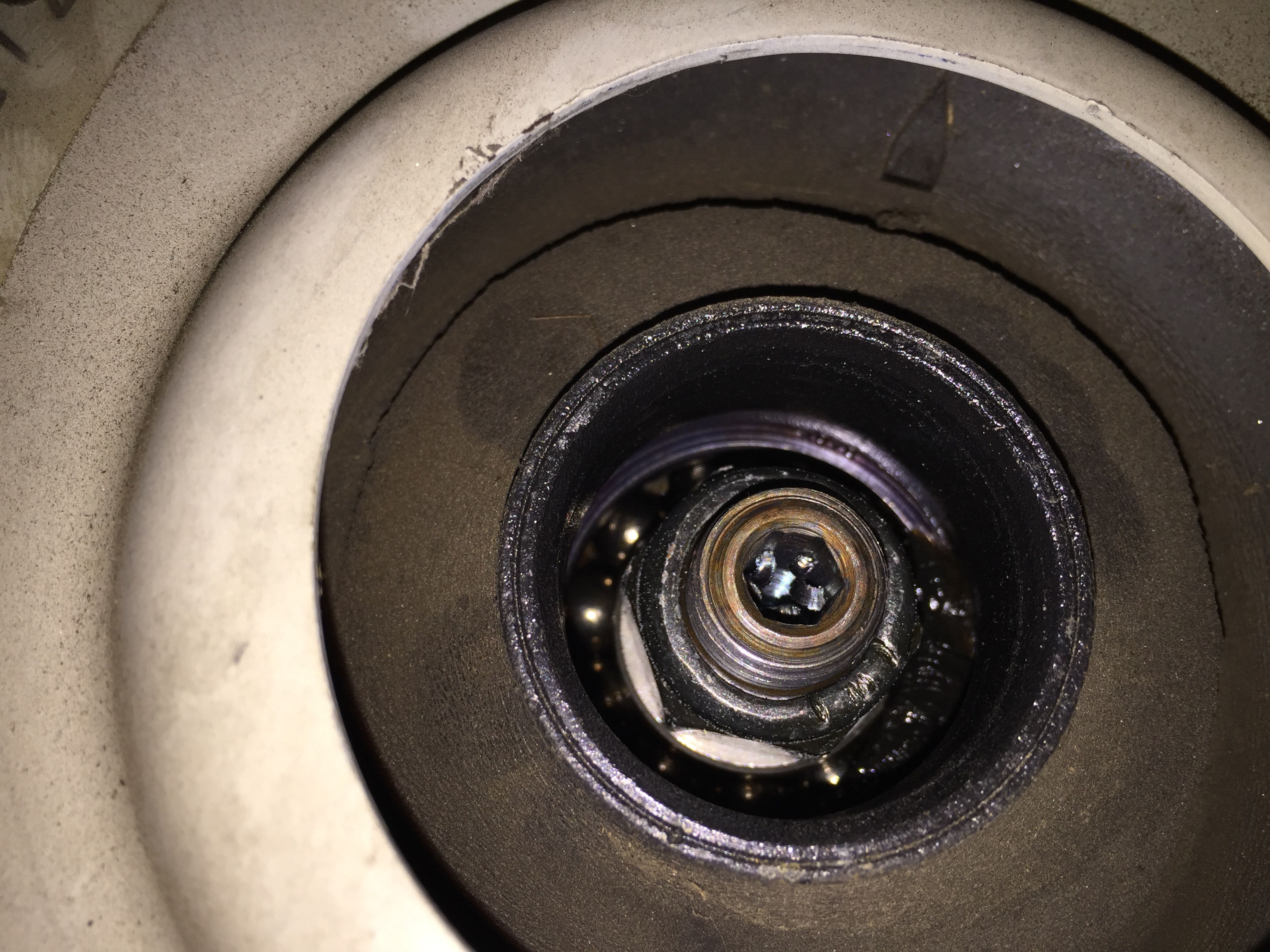

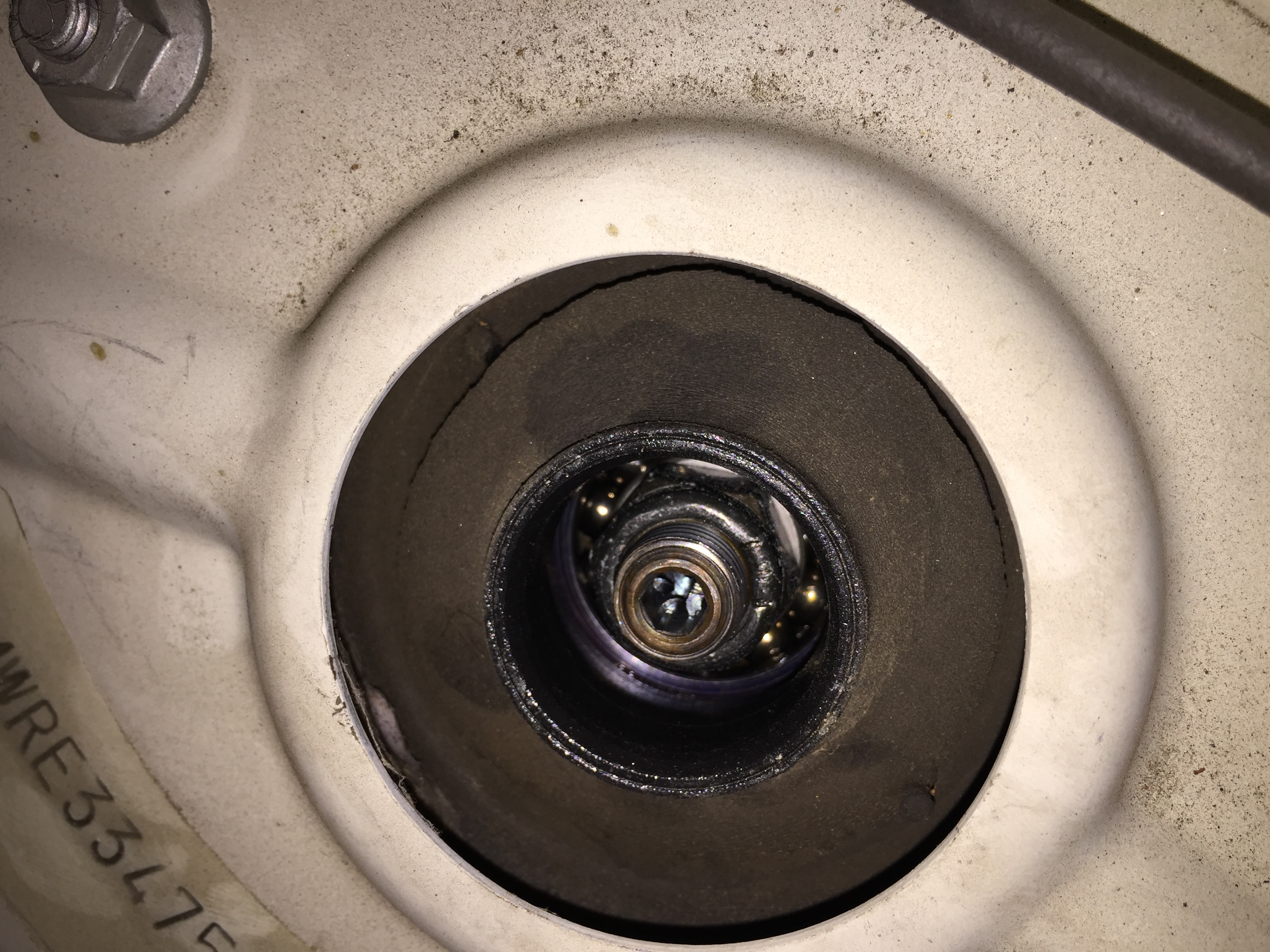

Upper Strut Mount Failure! Help
Well, looks like my daughter's '05 MCS has a cracked USM on pass side!!
It's just under 50K miles, so I'm thinking I should probably have both sides replaced and may be freshen up the struts at the same time. I've been going to an Indy around the corner that very familiar with these cars.
Any suggestions as to which mounts and struts to go with???
Greatly appreciated.
The Bilstein Touring Class struts here and shocks here are a great replacement to go with. For the mounts go with Genuine or OEM supplier here. Be sure to do the front and rears while you have everything out. If you have any questions let me know!

It's at the Indy now, I believe I saw 'yellow' boots inside the coils, so imagine I have the bilstein shocks? What is better, the strut or shock? I will probably go Bilstein on all parts.
Thoughts?

Struts are the fronts (2) and shocks are the rear (2). I'm not sure what you have on there now, but you might be able to tell from the label. They may still be the original shocks/struts. The Bilstein's have a Bilstein label. They have a feel about the same or a little bit stiffer than stock.
