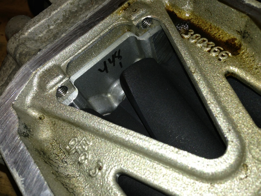

are my rotors coated or not?
i know this is hard to tell from the picture but its the only one i got.
and what its the psi diffrence between the the non-coated and coated? 1psi maybe? if so this may be the reason why i see a psi of two less than some other people.

ALL MINI M45 blowers had coated rotors. The difference is the early 2002-2004 cars had the light grey coating. Then the 05-06 cars had the dark grey almost black coating. The 05+ is suppose to be better as it is suppose to make the tolerance tighter helping make a touch more boost. But in reality we see the later coating come off more than the earlier coating. The boost difference is so small it can't really be measured.
And in your 1st pic there you have the earlier coating.
