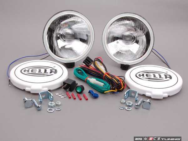

i picked up 4 hella 500ff driving lights for 70$ at xtremediesel.com

My Hella's would NOT fit on the OEM brackets.

why?
hole in the bracket not big enuf? drill it out.
making a mod to the factory bracket vs fabricating your own mounts? Well I'd say a mod is easier than building your own, but can go that way when I need to since I can cut sheet steel, bend it, drill it and weld it in my garage.
If this is intimidating then find someone to install 'em for you. IMO the factory kit does NOT make this easier as they made the wiring WAY overly complicated . . . mounting is easy but the wiring for full factory is a PITA.
2011 CR MCS
GEN1 vs GEN2 .... different brackets . . .
GEN1 factory setup has the lights hung to the bonnet; GEN2 has 'em below. If you don't want the OE look then roll your own and anything goes . . . light bar below bumper being the popular option.

Did you try the regular Hella 500's on the oem MINI bracket on Gen 1 MINI , think the hole needs drilled a little bigger for the bolt.
