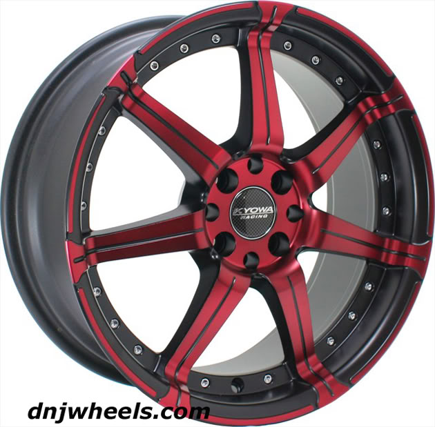

This coming summer I am thinking about going to this rim in either a 17 or 18.

18 will crush your back and your strut towers, i would stick with the 17 or 16
