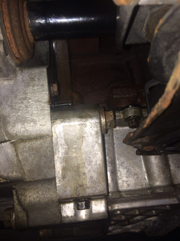

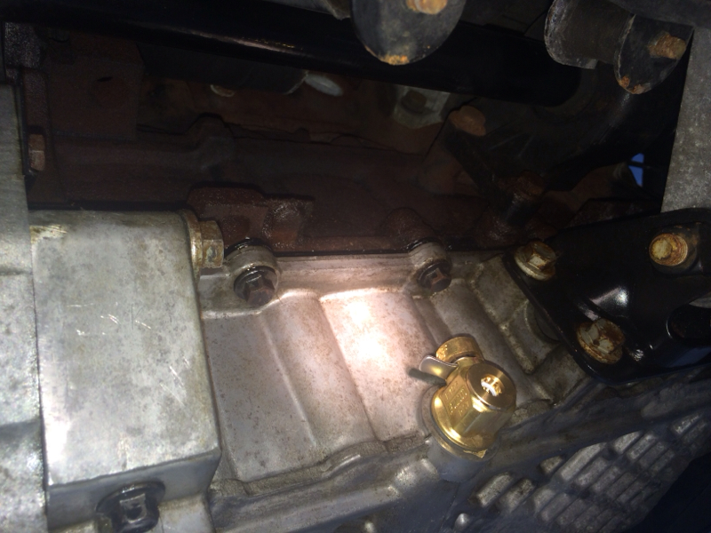

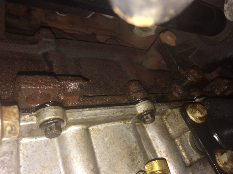

Here's the story.
I bought 5 quarts of oil, oil filter, and 2 quarts of transmission fluid because this would be the first time I changed the fluids in my MINI since I've owned it, and I wanted to have peace of mind that I was starting off fresh.
I have a 2005 MCS 6 speed. The car has 42,500 miles on it. Since it's been in my care, it has always been parked in my heated garage.
Recently, about 2 days before I changed all of the fluids, I noticed a tiny drop of black oil on the ground. After I finished changing the fluids/oil filter, I began driving it as usual. Now, I see about 2-3 drops on the ground every day when I pull it out of the garage.
I read as many threads as I could about areas of the engine that could possibly be leaking before I decided to start my own thread. I also took a few pictures of the area I believe is leaking.
Can anyone help me?
Attached Thumbnails Mysterious Oil Leak-image-3434025398.jpg   Mysterious Oil Leak-image-1239476608.jpg   Mysterious Oil Leak-image-2023856312.jpg   Mysterious Oil Leak-image-2522068957.jpg   Mysterious Oil Leak-image-4004493247.jpg

It looks as if my gasket is weeping but I'm not 100% sure. Because it only drips down the side under the driver's side.

Had the same exact thing with my 06 I took it to the dealer they put some kind of dye that showed up under light brought me back there and ran the car on the lift for a little while and I watched the oil start coming out from where the timing chain was and they said the gasket needed to be replaced but told me that they wouldn't recommend changing it because it was so minimal...A year later and a couple oil changes and it stopped leaking...I recommend having it checked out to make sure that's what it is but I'm almost 100% certain that's what your problem is...just check your oil weekly and you should be fine...1st gen Minis leak I've had almost every maintenance thing done to mine with a few more left but I'm pushing 114k on my 06 mcs jcw and it still runs like a champ...keep on motoring hope that helps :-)
Old Nov 7, 2013 | 12:11 PM
Cease's Avatar
Cease
Joined: May 2012
Posts: 132
I have a small leak as well. I ordered the crank position sensor gasket which is a common cause of oil leaks in our cars. This leak can look like the oil pan gasket because of how the oil leaks out. The piece is like $1.00, there is a way to change the gasket using a ratchet strap but I plan on doing it the long way (putting the car in service position) and cleaning the front of the block.
That being said, since you just changed your oil and it was your first time check the filter housing and everything you removed. Good luck!

Looks like it's coming off the back of the block, rather than the front where the CPS lives. Given that it started after the change, my first suspect would be the oil filter housing. I'd start by reaching down and wiping that area with a paper towel and see if you get any residual. Usually when they don't seal (i.e. o-ring gets compromised), it happens in rather dramatic fashion. But I'd still start there.

It started about 2 days before I changed the oil.
I already checked the housing very thoroughly. No drips, residue...etc

As I was looking through my carfax, I found out that the oil pan gasket on my r53 was changed at 30k miles. (I bought the car with 38k miles).
The car now has 43k miles. I checked my t-stat, my crank sensor o ring, and everything else it possibly could be. Everything seemed to be in order. I replaced my upper engine mount (passenger side).
This has to be my oil pan gasket. Is this a common issue with the r53? WHY?
