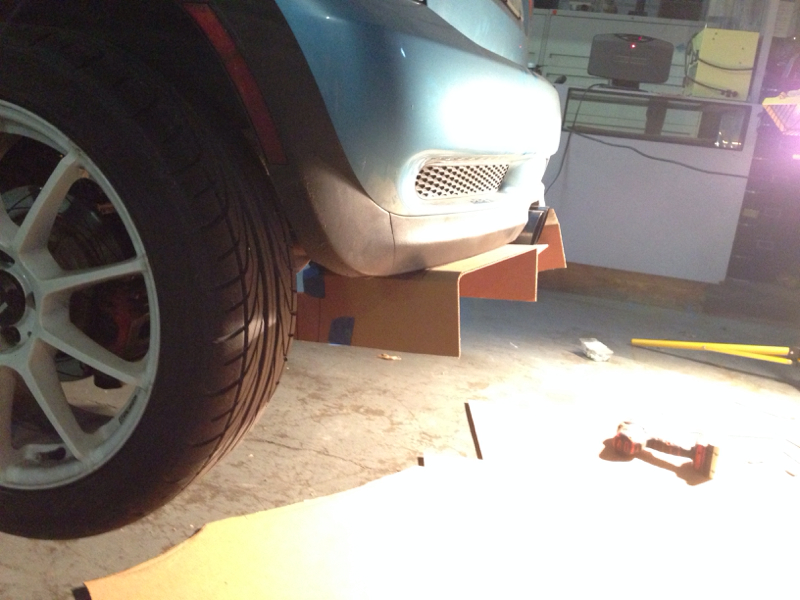

Well title says it all. Basically what I am doing is attaching a defuser to the bottom of the rear bumper trim. I notice a lot cut the trim but this IMO looks just as good with less work. I've got the cardboard template worked out Making my own fiberglass/carbon fiber rear diffuser.-image-3183412831.jpg Making my own fiberglass/carbon fiber rear diffuser.-image-1538605952.jpg Making my own fiberglass/carbon fiber rear diffuser.-image-3701149922.jpg The passenger side in this picture wasn't trimmed up to fit the exhaust so it's hanging lower on that side. Making my own fiberglass/carbon fiber rear diffuser.-image-469308809.jpg Making my own fiberglass/carbon fiber rear diffuser.-image-3030766799.jpg Making my own fiberglass/carbon fiber rear diffuser.-image-2305420770.jpg
Making my own fiberglass/carbon fiber rear diffuser.-image-1757841354.jpg
Already starting some fiberglass on it.
Making my own fiberglass/carbon fiber rear diffuser.-image-976620218.jpg
Attached Thumbnails Making my own fiberglass/carbon fiber rear diffuser.-image-2713737413.jpg

I debated doing mine from steel because I want to also make a front lip I'll probably end up doing it all with fiberglass and carbon fiber. If I would of done it with steel I don't think it would have came out quite as nice of quality having a ton of brackets and such holding pieces together probably would of had to fiberglass that as well and I don't think it would look as good so thin. When I am done it will be about 1/2" thick and you'll just see carbon fiber clear coated in. It sucks they don't make any diffusers for the Y exhaust. Only way around making your own if you have an r53 is to remove battery box and convert to r56 exhaust and rear end from the new minis and do the gp2 diffuser. I pieced everything together last night and took a shot before I began fiberglassing the whole top.

Well yes and no. No because fiberglass against my exhaust was going to start a fire. Yes because I switch materials.

Pretty good craftsmanship. Looks like he maybe used some sort of black lexan plastic? This is the material used for my rear diffuser. Pretty awesome stuff.
