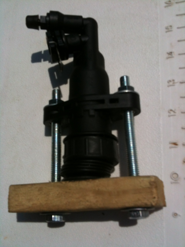

I've previously bled the clutch slave and just kept it in place , after the job was completed I did it again but there was no air coming out so that went great, I didn't have any problems at all, I made my own tool with wood and bolts to compress the slave and it worked great, pelican DIY calls for replacing of the masters as we'll but it's just a recommendation .. I guess.
