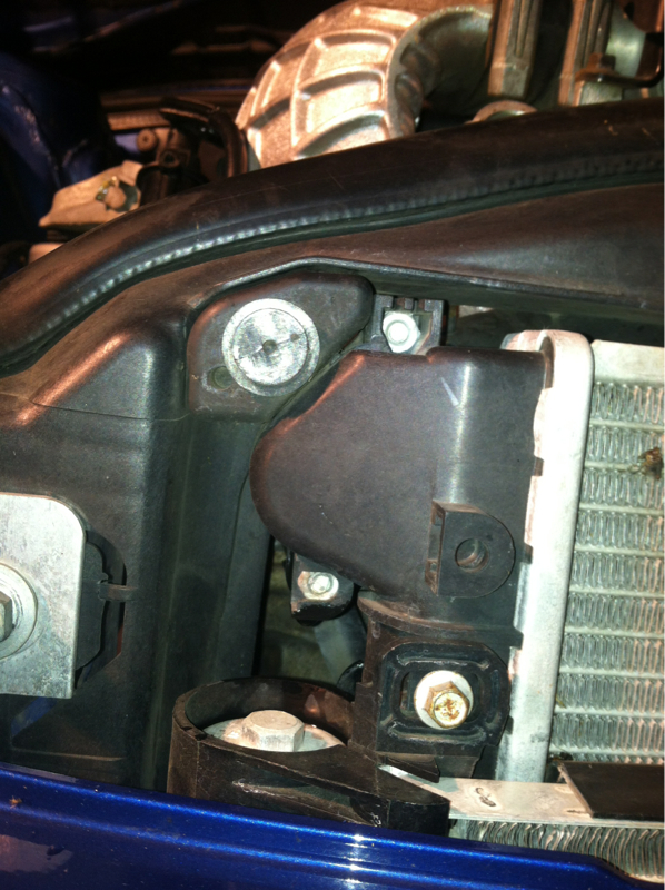

I noticed that I have a small, slow, drip...drip from my radiator.
It's right below where the upper hose connects to the radiator. Infact, it appears like there's a flange where the plastic 90^ pipe bolts on to the side of the top of the plastic radiator tank. I haven't taken off the fan shroud, nor removed the radiator, its hard to see. I know for sure it's not the upper hose or hose clamp that's leaking.
Can I unbolt that flange and put in a new gasket? What about the 90^ plastic pipe, replaceable?

Here's a photo of the back side of where it leaks,....

Inspect the flange seal and reseal it. I did that before.
Now if there is a crack then that's a different story.

Another (cropped) photo. Drip comes from near the lower nut in this photo.
The parts I'm looking for are the gasket and plastic pipe that are held on by the two nuts in the photo.

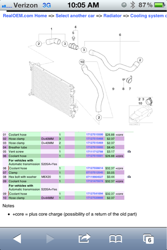

Also, this diagram makes it look like the plastic pipe is a part of the radiatator, not a seperate part, and no gasket shown either....
::confused

The part comes as the whole radiator. I would check to see if it just needs tightened or the gasket re-seated. If it still leaks you might have a hairline crack in the plastic.
The neck / seal on the top and the bottom that bolt to the radiator are not a separate part, and come with a new radiator.

You can get s gen1 aftermarket copy of the OEM for about $100 on rock auto...
The plastic connectors tend to get brittle with age... Made worse by folks sometimes using an aftermarket screw clamps too tight....much tighter than the OEM style spring clamp.
My guess is, if you manage to fix/replace the broken plastic part, the plastic used in the radiator, where the tubes are melted to the ends, might be almost at the end of its life...they crack and leak there too after about 10 years or so....

If anyone has similar problem, and try's to repair it with some form a gasket sealant, my advice is pull the radiator.
So I unbolted the elbow, looked like the flange was a little bit warped, barely noticeable with a straight edge.... probably the source of the problem.
Went to napa in search of a replacement elbow, or at least o-ring. No elbow, but They had two o-ring that were the right circumsfrance to fit the hole, but the guage was either too fat or too skinny for the groove it fits into.
My original o-ring didn't look too bad. It was a little squished on one side, I just flipped it over. I thought the Form-A-Gasket stuff I got might seal it up enough anyway, taking up the gap of the slight warp on the mating surface flange.
I think I could have done a better job if I would have taken time to remove the radiator, or at least slide out the MFE to service mode.
I felt like it was drying too fast (directions say to clamp the two pieces together while its tacky... And to my surprise, the window there seems to be only a few minutes -maybe i should mot have gotten the 'fast drying' one) and it was difficult to negotiate the elbow into place with the dipstick tube being in the way. I did get it bolted back securely, but i think i took too long, and I think I may have messed it up.
I'll wait till tomorrow to try to fill, burp, etc the coolant into it. -Please cross your fingers for me.... The mishimoto will be cool if I have to replace the radiator, but I was hoping to use the funds elsewhere on the mini first.
