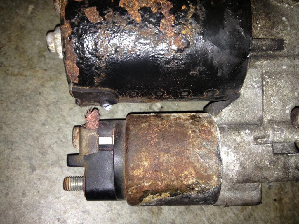

Update: Problem found
UPDATE:
Here is what I found!
Looking From underneath the car, I spy the wire stretching from the solenoid to the starter itself....It....it looks frayed?
[IMG][/IMG]
Here is what the starter looks like after removing it!

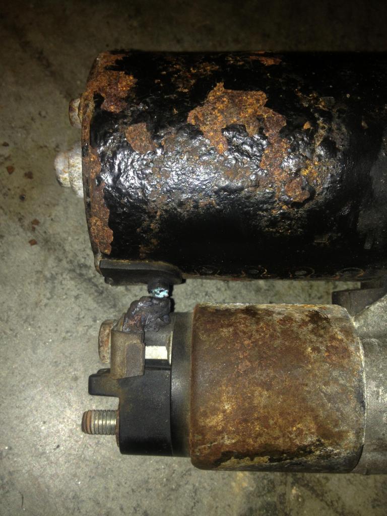

I picked at the plastic a little bit and the wire fell apart in my hands
OH MAN THIS IS BAAD. Found the problem. Bad Wire! Now...where to buy a reliable bosch starter part number 0 001 106 018 that wont destroy my wallet, and isnt a questionable one from Ebay...hmmm

You sure that car wasn't flood-damaged?
Old Sep 4, 2013 | 06:08 PM
SooperCoopers's Avatar
SooperCoopers
Joined: Feb 2013
Posts: 57
Wasnt flood damaged. But the car is from New England so the weather does its course on the car for sure

The salt and corrosion from the north east can really do a number on the cable between starter and the solenoid. The cable does not have a separate part number, and with rust like that its maybe creeping into the internals.
We have the Genuine MINI one here if you need it. Part number 12417570488KT
