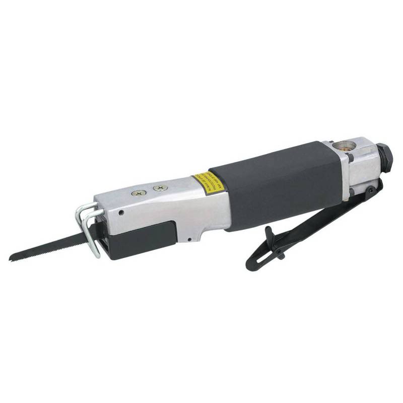

It just takes some time & patience to cut off, but it can be done better to take all day than to damage the shaft, do as mentioned above, 2 cuts, 180* from each other, sometimes one will work but remember, with one you're applying a lot of force to only one side of the shaft to try & split the pulley, just keep some extra cutting discs on hand. If you had access to air, an Air Body Saw* is actually the quickest & most acurate way to minimize the risk of damaging the shaft.
* Name:  image_11763.jpg
Good Luck.
(this is actually a common problem with JCW pulley removal, a lot of vendors that do this will not quote a definate price on JCW pulley swaps just because of the unknown extra time involved with the removal)
