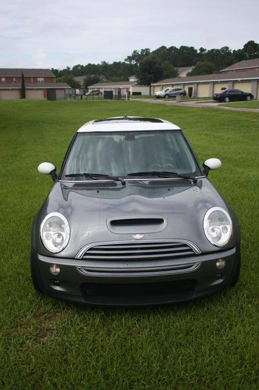

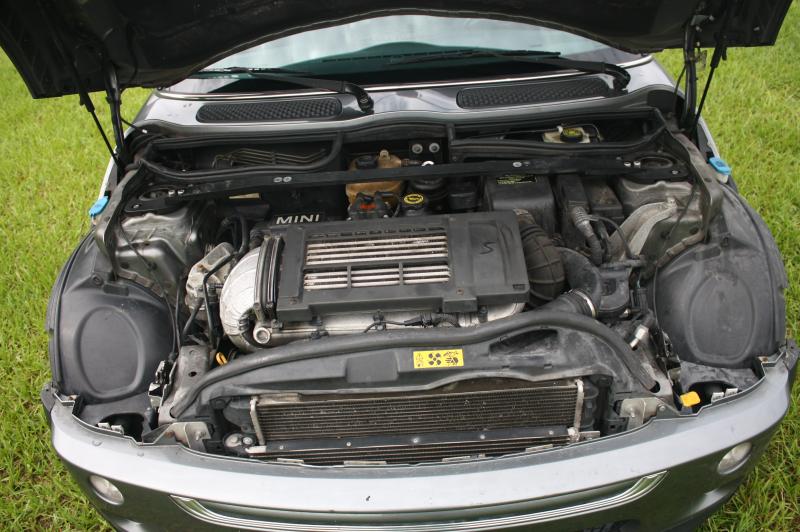

So I find it appropriate to make my own thread covering the repair and upgrading of my '04 MCS. To start if off, some photos of how it currently sits.
I just put some used tires on the rear that are not the same size as the fronts just to get by for now but I am going to spare my embarresment and not show those willingly. The right rear had a flat spot from skidding and belts showing.
