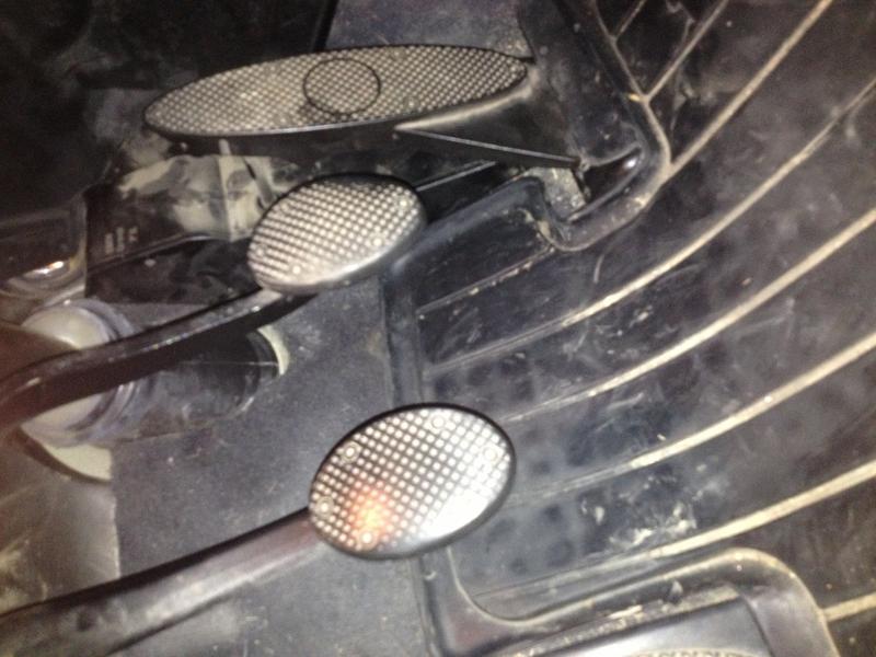

Step One: Get under the dash and remove the gas petal assembly. (little tab on brake petal side then it slides right off)
Step Two: Remove Carpeting (not sure how to do this, as I cut through mine..mine's dying, who cares)
Step 3: Get under the car and drill a hole directly above the bolt needing to be removed, this is your marker (Oh yea...this is that kind of instruction sheet)
Step 4: Use a dremel (or a jigsaw, or really whatever you want, its thin metal) to cut a hole around that little hole you just drilled. Make sure its big enough to access the bolt with a socket.
(See Picture 1)
(See Picture 1)
