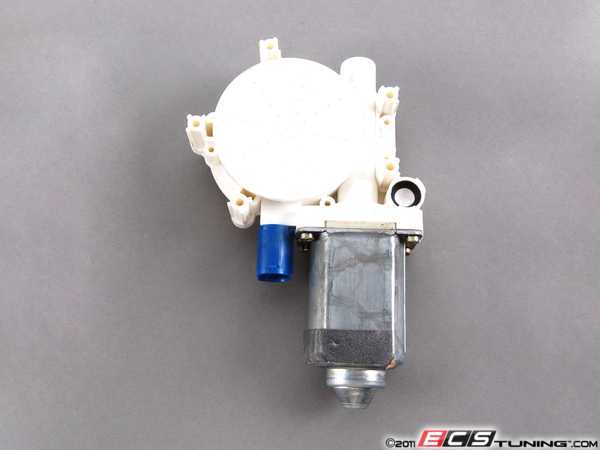

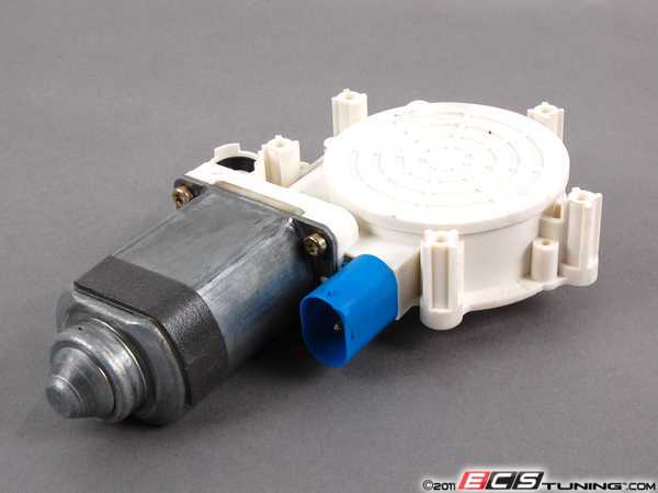

Thanks, you did not mention which side, passenger or driver so here is both. You are in the years with production to 6/2005.
Left side ( driver ) Window Motor
http://www.ecstuning.com/Search/67626955875/
Left side ( Passenger ) Window Regulator
http://www.ecstuning.com/Search/51337039451/
Right side ( driver ) Window Motor
http://www.ecstuning.com/Search/67626955876/
Right side ( driver ) Window Regulator
http://www.ecstuning.com/Search/51337039452/
