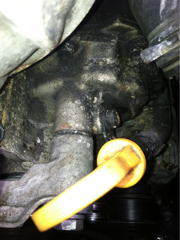

R50/53 Does anyone have any idea were this may be coming from
I tried to upload a picture from my phone but it won't work but there is a bunch of oil or something getting flung everywhere on the dipstick side and it smokes after driving for a while or hard driving but my oil lever doesn't seem to be going down
Attached Thumbnails Does anyone have any idea were this may be coming from-image-3654005282.jpg

Wait it did work it told me it didn't

That looks like coolant. If so, probably a leak in the radiator.

It looks like oil before it dries up but I don't think oil looks like that does it it is even going up on the headlight light like its getting on the belt and flinging it everywhere

If your oil level isn't going down is your coolant level going down? Because it looks like coolant to me as well..lol..

It is but we're could it be coming from?

If you cant see it coming from a location in your car I would pressurize your cooling system...That is the easiest way to spot a leak... Sometimes by just running the car is very hard to tell where it is at.. It evaporates before you can see it.. But by the way you make it sound...it sounds like you have a good size leak..lol

Ya but it would have to be coming from that side because all the dried up coolant or whatever is only on that side of the car

Just guessing here...But I think it might be your water pump...lol.. So as your standing in front of the car is the leak in the front left side?

Ya it's on the front left side

That's why I feel its the water pump... Its in that location.. plus that tends to be a common thing to go out..lol.. Now with that said that does not mean at all that it is the water pump...It could be anything.. The best thing for you to do is have it looked at.. Because your still not sure if its oil or coolant.. Plus I don't know how much you work on your own cars when it comes to this type of thing.. Ive been working on MINIs for awhile now..with out seeing it..it would be wrong for me to tell you forsure what is wrong with it.. If you have any questions I would be more then happy to give you ideas of what it could be.. It would be up to you to verify the problem.. Good Luck and keep us posted

I must differ with 'ZippyS'. That clearly looks to me as if it is near the pulley end of the supercharger; water pump is at the other end.

That is my fault.. I should ask if you are talking driver side or passenger side so I don't get confused myself.. JAB 67 good catch on that! Thanks!!!

Since the end of the radiator hose IS just in the edge of the picture...it might have chafed, or have a small leak....feel around...look around. Changing a hose is easy...but bleeding a gen1 mini is a pain once it hasgone low on coolant....
that and i bet you car might be overdue for a full coolant change..THE MOST overlookeditem in mini mx. Next thing....look at the radiator....they can leak on mini's where the plastic is crimped onto thr metal part...all modern oem rads are built like this....aftermarket copies are $85-90, oem is like $300+.

That's the thing I do all my own work I just put on a 17% pulley and dt bpv I just got done taking a motor out of a civic and putting a new one in I can fix whatever it is I just can't find where it is coming from

It ended up being my radiator it was leaking were they crimped the plastic on and just blowing off while driving which also explain my coolant level going down I ended up ordering a mishimoto radiator just got it today thanks everyone for the help!

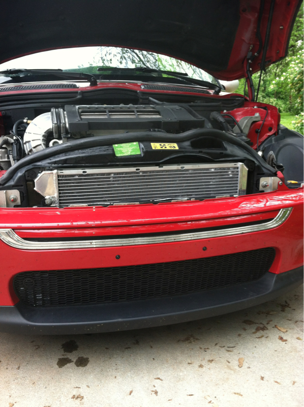

Got my new mishimoto radiator in
Attached Thumbnails Does anyone have any idea were this may be coming from-image-4196251328.jpg
Old May 27, 2013 | 05:58 PM
uromini's Avatar
uromini
Joined: Mar 2013
Posts: 203
From: Somerset, MA
That looks great in there..
