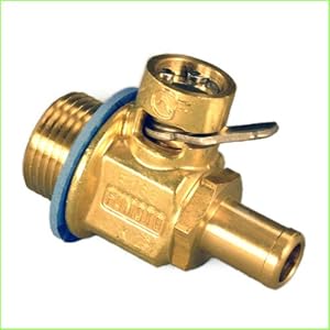

  • I replaced the drain plug with a Fumoto. I used a deep socket to get past the "nipple" and to the hexagonal base in order to torque it, but the hex end unfortunately rounded off before the torque wrench clicked. It wasn't on loosely by any means, but not being able to get it to torque spec didn't make me feel confident.

The Fumoto plug indeed had a gasket like in this image: http://ecx.images-amazon.com/images/...cL._SY300_.jpg I held on to the existing drain plug just in case, as it actually appeared to be in pretty good condition, although I've read it's not advisable to reuse them.

I'd still like to torque my Fumoto valve to 25-29ft-lbs as their website suggests, but I don't know how that can be accomplished with it being too round for a socket... Unless I just replace it, but then I don't see what's stopping me from doing the same thing again. The fact that I was able to round off anything indicates it's on pretty tightly, but I guess I'm just a by-the-book kind of guy.

I've heard that some people weld a larger nut on top of the original nut.

...what size socket did you use to tighten that fumoto? The correct one?
As much as I like things to be torqued to spec, the German torque spec of good-n-tight works just fine and there's no sense in replacing it now or stripping it farther. Grab the smallest box end or open ended wrench that will fit on it and tighten one last time and don't mess with it.
