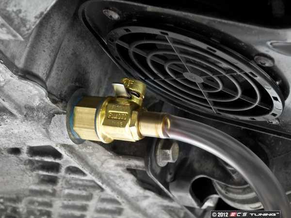

Click the picture: F106NMINIKT
Gen 1 : R50 R52 R53 models.
Old Feb 18, 2013 | 06:42 PM
Rich.Wolfson's Avatar
Rich.Wolfson
Joined: Dec 2002
Posts: 1,266
From: Northern New Jersey
I have two questions. The picture has the valve lever at the top. How can we be assured that it will end up there and not at the bottom where it is more exposed?
Also, what is the function of the second brass block?
Thanks in advance.
Rich
Old Feb 19, 2013 | 05:03 AM
Capt_bj's Avatar
Capt_bj
Posts: 7,037
Likes: 283
From: Melbourne, FL
ECS is including the stand off adapter who's function is
"The adapter is designed to add extra length to the valve so that you can install the valve without hitting the oil pan wall. "
and a piece of plastic tubing to use with the 'nipple' to direct the stream . . . (no wise cracks)
In my experience my Miata had a recess in the oil pan the plug/valve would sit in and this adapter was necessary to push the valve clear of this recess.
having installed at least a half dozen F-106 (some N and some plain) on GEN1 MINI including my own, IMO the adapter is not needed but won't hurt anything. I don't use the adapter on MINI. The valve part has ALWAYS ended pointing UP. The threads in the pan and the valve are cast in so they aren't 'random' in orientation is my guess, but every Fumoto I've installed ended up with the valve oriented in a safe direction. {which is why you DON'T try and use one on a GEN2 where the entire gizmo would point straight down}
Ordering direct from Qwikvalve (Fumoto's retail outlet) it is 23.96 plain, 26.95 with the nipple allowing a hose to be attached. Got a friend or another car you might want one for? Order 2 and shipping is free in the US..
