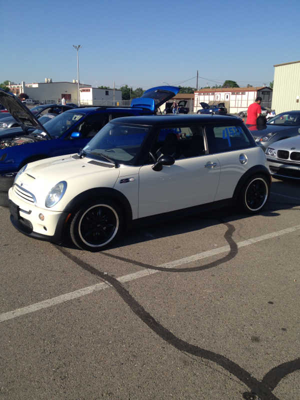

If your going to install the megans and only do street driving i wouldnt worry to much about adjustable arms. I have the megans installed, lowered about an inch.. Not sure how much neg i have in the rear but its not to bad.
