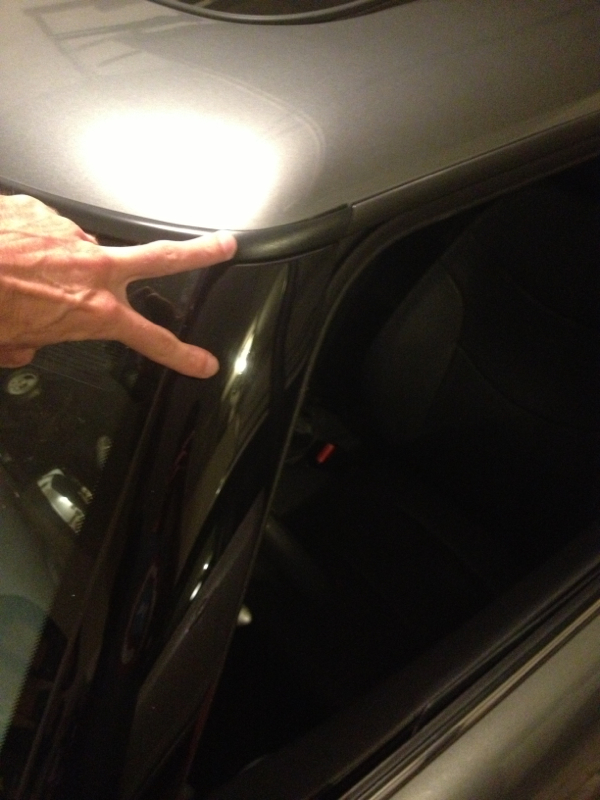

How do you remove these two pieces of trim?

There should be a snap at the front. Pull it carefully away from the a-pillar, as those pieces break very easily. Once you unfasten the tab, pull the trim piece towards the front of the car and it should easily come out.

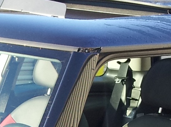

Ah, sorry, I thought you just meant the pieces above the a-pillar. My car was missing them when I bought it and I've since replaced them and secured them with some adhesive. The pic is from when I first got the car. You can see the position of the clip which was left in place when the piece broke off. Once that's free, you can just pull the whole piece forward.
As for the a-pillar itself, I think you have to remove the trim from the interior of the a-pillar to get at the back of the clips to safely remove them. I found a few some detailed instructions about this while I was looking for the top trim pieces; If I find them again, I'll post a link here.
