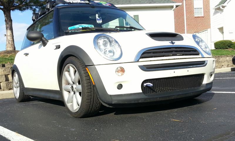

I dont have any pics that I havent uploaded here (can't post duplicates) but I'll take a few in a bit. I don't have any spacers in the rear because my RL rubs over bumps thanks to, for some reason I can't quite figure, the RL inner fender trim seems closer to the tire than the RR even though my ride height is balanced. I'd need more camber (or thinner tires) to allow the rear to run spacers. It doesn't look like the front track width is noticeably wider (to me) other than a slight exaggeration of the "bulldog" stance.

If the app shrinks these photos....
Fronts are about 1/2 way through the adjustment...any lower and I can't make it over the speedbumps to get to my apt and rears are a little under an inch from slammed...any lower and I'd have some decent rubs nearly all the time.
