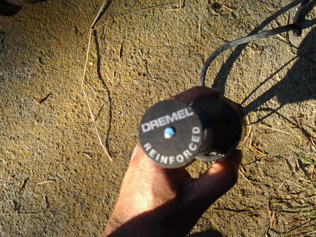

I also learned that its best have a new torx bolt for the mount when working on the project.
Mine was really rusted and wouldn't budge.
Eventually i stripped my bolt head and had to use the Dremel to cut off the head of the bolt as you can see from the picture. If you have an impact wrench I'm sure this wouldn't be a problem.
Now I still have a shake in my seat. I have shorted it down to 3 possible causes.
