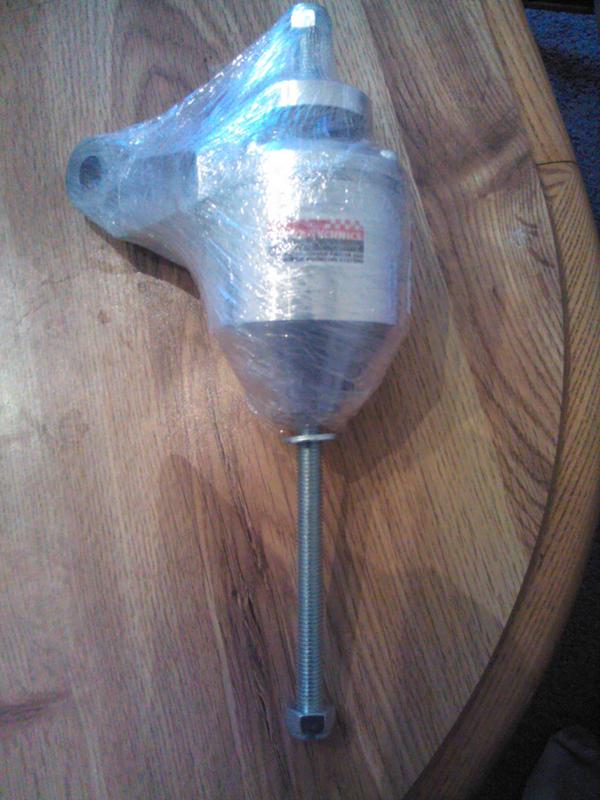

Here's what my VT mount looks like (obviously not installed yet). You could probably find some installed pictures on this forum or through Google.
Attached Thumbnails tsw motor mount and VIP engine damper-img_20120822_115445.jpg

I emailed them and im curious, what is so special about VT's motor mount? and guess im staying with the stock motor mount since i have the VIP Engine Damper already.

Well my OEM mount had failed before I bought my R53...which had 43k on the clock when I bought it. I've heard of OEM mounts failing earlier than that as well...so I didn't want to get another OEM mount that was going to inevitably fail before the car even hit 100k miles. The only two aftermarket mounts I know of are the TSW mount and the VT mount. I was planning on ordering the TSW mount until I started researching it and found out that many people were unhappy with the level of vibration this mount transfers to the chassis. The VT has rubber dampening, as opposed to the fluid filled OEM mount (who at BMW thought that was a good idea?). The TSW mount is solid polyurethane, which is stiffer than rubber...therefore in terms of damping, the VT mount falls right in the middle, and according to the testimonials I've read the VT mount isolates the engine vibrations better than the TSW mount, but still allows the engine to put the power down much better than stock.
