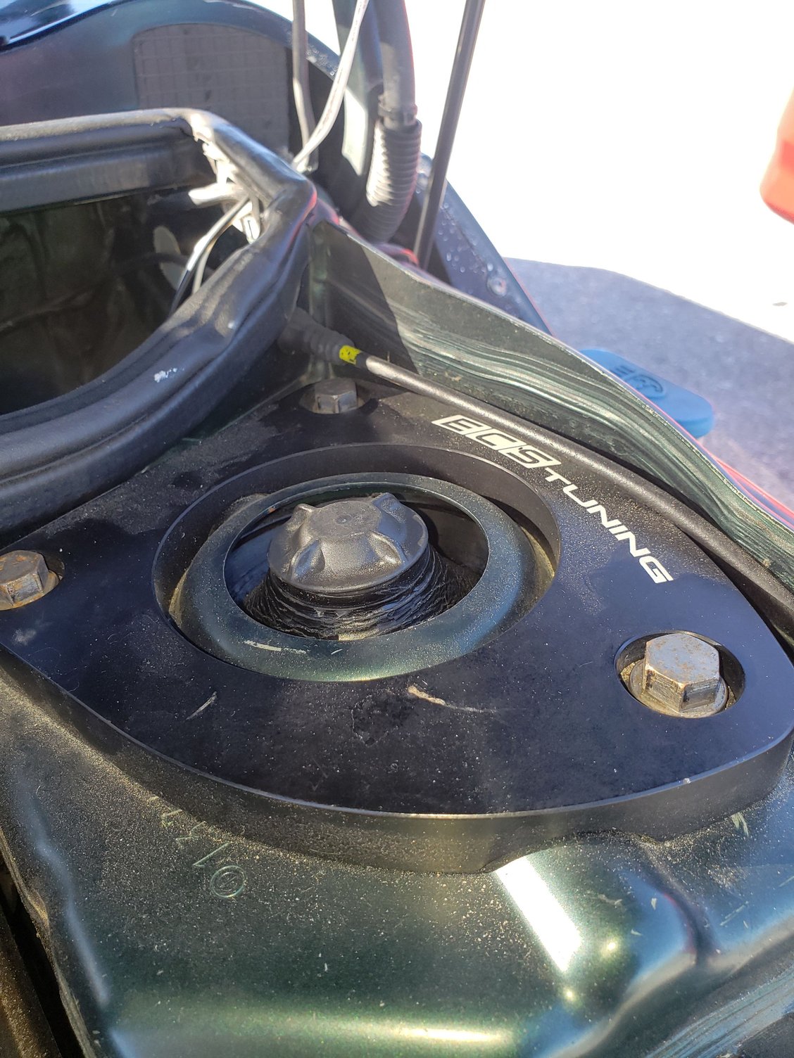

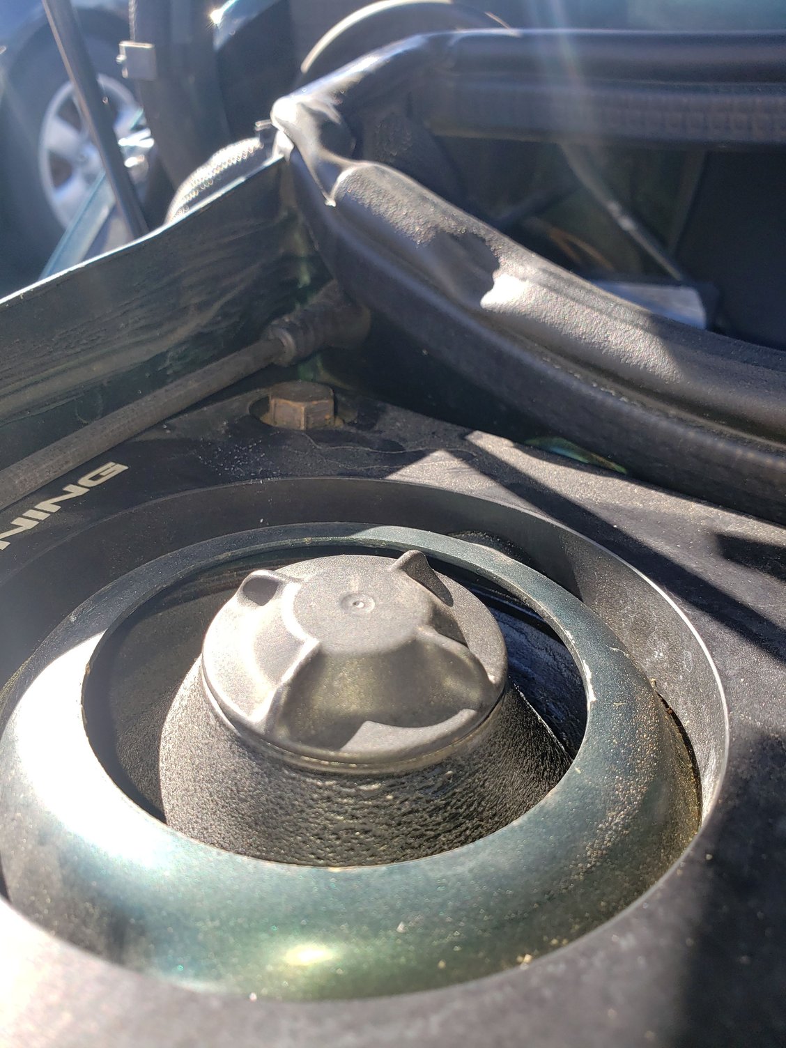

shrevemini's Avatar
shrevemini
Top Answer: 1
Joined: Jan 2014
Posts: 1,140
Likes: 329
From: Panama City Beach Florida
These were KYB after a 400 miles trip. Newly installed.
The second pic is a Bipmac mount from Amazon. They lasted about 200 miles.
I replaced them with lemfeder mount. 15k on them. No issues.
