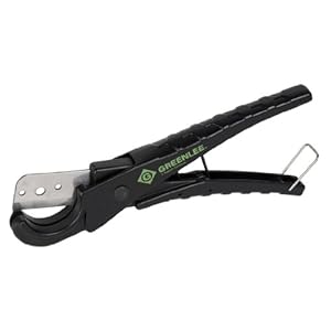

@ ERIK06MCS: Good Idea.. Any thoughts on the best way to cut this tubing? I dont wanna risk squashing it ..
Old Jul 3, 2012 | 10:55 AM
ACEkraut11's Avatar
ACEkraut11
Joined: Oct 2007
Posts: 1,559
From: Durham, Maine
As long as you have access, these cutters work really well:
Amazon Amazon
Similar cutters are sold at most tool stores like Lowes, Home Depot, Sears, etc. They are also great cutters to have in your tool box. Work great on hoses, etc to give really nice clean cuts.

It'll definitely be tricky because the plastic may crack/break instead of cut nicely. Make sure whatever you use is very sharp and not dull. That'll prevent breaking/cracking. Also, go slow, Maybe use a tool like that pictured above, apply pressure and keep rotating the tool around in a circular motion like how you would use a pipe cutter. By taking your time you should be able to cut/carve the line without squishing or cracking.
