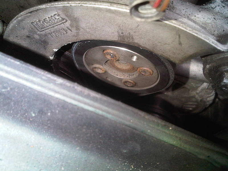

Just to be clear, this IS in fact my pulley, and it IS in fact a STOCK pulley right?
God I hate being a n00b...
Not stock...
NO that is not a stock pulley. Looks like it may be a Minimania pulley, but your car already has a pulley so you are modded.
Sweeeeeet.... I was actually looking at your pulley packages earlier yesterday thinking I'd be needing it. Guess i can save the money for Xenons :P
Thanks again for everyones help. I've gone from debating, to researching, to realizing I already have this upgrade done! hahahhaa
