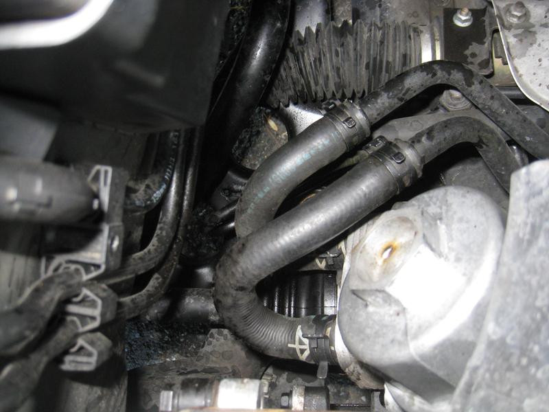

Here is a picture of the area that is in question.

We use brake clean, it drys up better.

what is break clean? is it something you spray out of a can? can i spray that on rubber parts/hoses?
