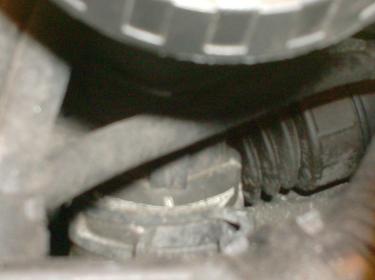

#1. Looking straight-down from the pressure cap, you can just barely make-out the white markings on the hose, and a portion of the clamp.
#2. A closer look - same angle as #1

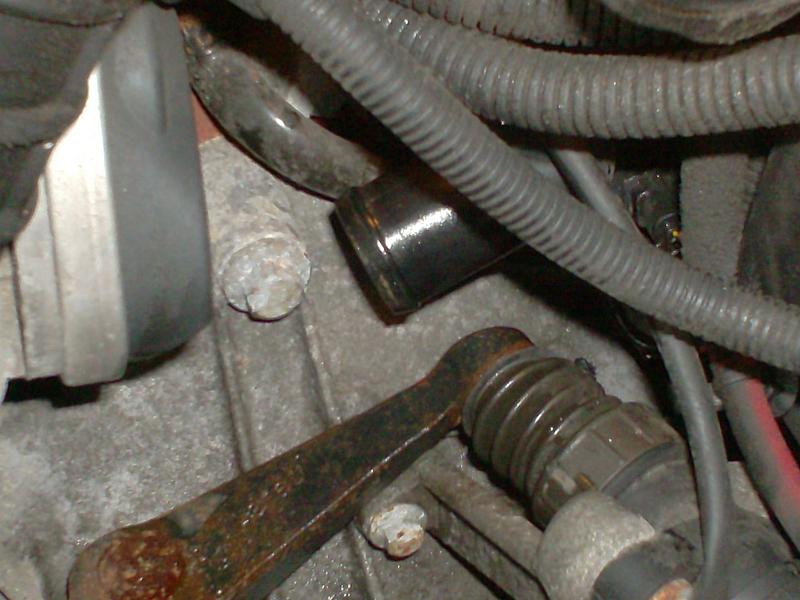

#3. The black-plastic water flange/outlet after hose removal - from the left (drivers) side.

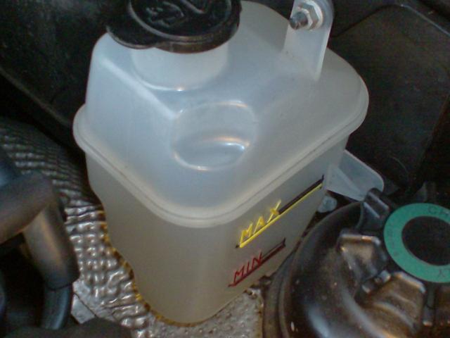

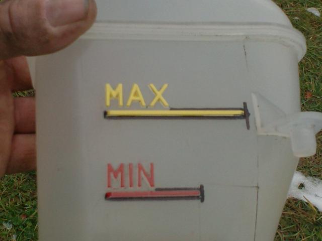

Here's a few extra pics. My "MOD" to the expansion tank (I really kinda like it!), and the weather I had today (28/30 degrees, damp as you can see - and "breezy" ...view looking east from the site of my "hose-job"
