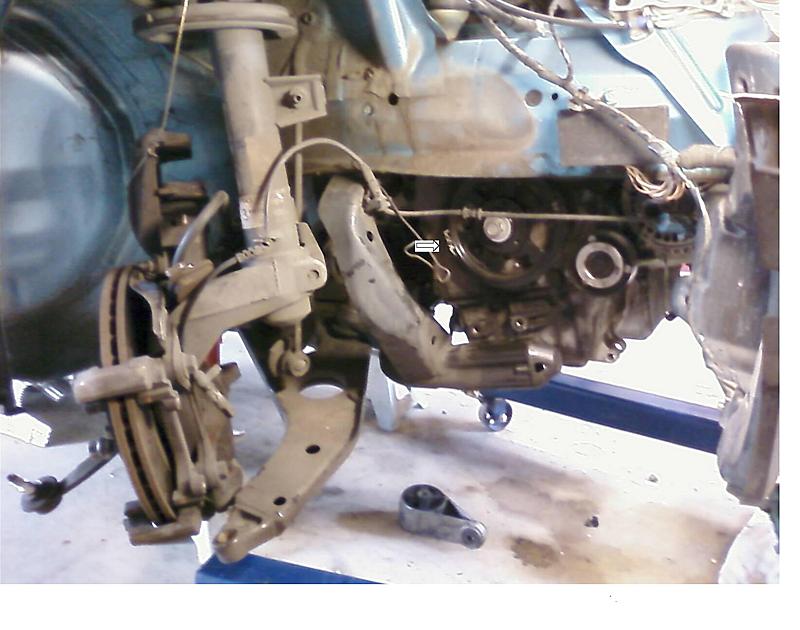

I have a R53 and replaced my crank pully with an Alta. Works great lasts long time. The lower weight is a benifit as well. You will increase horse power by lowering rotating mass. Here is a picture of the crank pully i put on my 02 Cooper S Electric Blue R53. Good Luck.

Forgot the pic.
Here is the picture of the crank pully. The arrow points to the pully.
