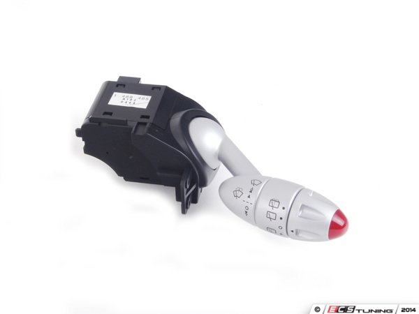

In a 2005, I have the low washer fluid light on the WIPER STALK. Does the replacement stalk go onto the LIGHT SWITCH STALK with a red light on that end?
I emailed MorristownMini Parts and they said that the low washer fluid light will now go onto the light stalk and the red light will now go onto the wiper stalk. That makes no sense to me!

Yes, I believe so. I would check with Classic MINI (bmwparts@classicautocampus.com) Tell them you're with NAM and get a 20% discount.

I'll second that, the red light goes on the light switch stalk.

I just installed the OEM alarm on my sister's '06 MCS. Got the best deal from Classic MINI.
Part number for the kit: 65 73 0 403 439
You'll need to order a new turn signal stalk, as it's not part of the above kit. The new signal stalk will have the red light on the end.
Attached are the instructions for the alarm installation kit. It took me about 30 mins to install all the components, and the dealer charged 30mins to flash the body control module.

Thanks guys! Great info! Just what I thought, the new light stalk is what I need. Makes perfect sense. I don't think classic mini ships to canada.

I am finding that BMW no longer makes this alarm system, P/N 61-31-1-489-485. My local dealer doesn't have it, Pelican Parts doesn't have it, Classic Auto doesn't have...does anyone have any sources for this?

check ecstuning.com just ordered mine from them! waiting for delivery.

We can get it. 61311489485

We definitely have that part. It is listed here.
If you have the part number, typically if you paste it in the search bar on our site it will bring up the part if you cannot find it searching through the catalog.
