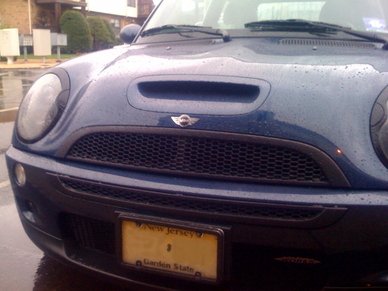

Just installed my Aero Grill.
Wish I had come across these instructions earlier:
http://www.grillcraft.com/installs/i...install_id=166
Pretty good visuals to show what you need to remove to get the bumper off.
I might try to remount the lower grill as I feel it might stick out a bit too much on the sides.
Attached Thumbnails Aero Grill Install-cargrill1.jpg   Aero Grill Install-car1.jpeg

Yeah it's totally sticking out. I'm a bit of a perfectionist so I'd get it to sit flush; but that's my preference. Take a bit of time to do it and you'll find it much more satisfying.

Looks good. But like MRCOOPERS stated I'd try to get it flush. Unless of course your happy with it like that. But other than that looks good. I like the color of your MCS It's very nice.

Do you guys remember how much trimming you had to do? I took off about 1/4" on the bottom, up the sides to 2 1/4" in. I didn't remove anything from the upper middle portion of the grill.
Did you cut the middle portion out of the bumper?
Old Apr 21, 2009 | 06:15 AM
DrPhilGandini's Avatar
DrPhilGandini
My little dose of LITHIUM
Joined: Jul 2005
Posts: 2,435
From: Albuquerque New Mexico
You should cut/trim the middle grille (fits at the top of the bumper, not the bonnet). Cheaper (relatively) to replace messed up grille than messed up bumper...
You should cut quite a bit to get it flush, but trial and error is the best method.
Good luck

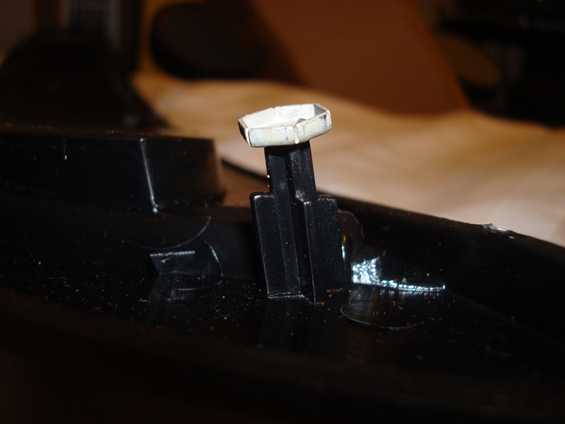

How did you attach the aero grill to the hood? The hood has those plastic screws, but the aero grill has push type ends...nothing to screw the original 10 mm whatchmacallits.

People say you can reuse the self tapping nuts that held the original grill onto the hood. They do seem to match up, but I've heard of people having difficulty with them. I felt they were such a poor choice, considering how difficult they were to get off, I decided not to use them.

The grille is made to use the OEM nuts. While they seem a bit hinky, they actually do work - they're made to thread on, then spin when they get into place. To remove them, you have to pry them upward with a little flatblade screwdriver while turning them with a nutdriver.
Personally, I'd want nuts on there in addition to silicone....
You CAN get some more "normal" nuts from the hardware store and thread those onto the plastic studs. I've seen folks do that also.

K: I hope i didn't order the wrong grill. FYI my mini is a 2005 mcs, april build.
See DSC01664 of the aero grill (note that there aren't any threads to use the original "bolts")
See DSC01668 for the "bolt" on top of the "Peg"
Please let me know what to do...

Someone correct me if I'm wrong but those nuts will create the threaded part of the stud if you just apply enough pressure.
Old Jul 3, 2009 | 02:26 AM
mkskchun85's Avatar
mkskchun85
Joined: Jul 2008
Posts: 65
Okay you're right. I didn't think about trying to create the threads with the grill off the car...i'm going to make the threads, then back the bolts off and then put them on...

Nooooooo. Don't do that - they'll "thread" on with the grille ON the car - once they're on, they're a bugger to get off, and they won't stay on as tight after the first time you thread them on!
