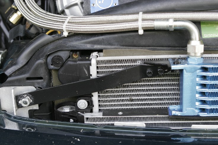

I went the route of installing a Madness oil cooler kit and used the temp and pressure sensor ports machined into the adapter plate.
I also used electric gauges; the pressure sensor is on a 17" braided hose that allowed me to remote mount it inside the ABS brake module "compartment" on the passenger side of the firewall.
The gauges are 2 1/16" AutoMeter short sweep in the Craven NavPod mount above the speedo/tach cluster on the steering column.

Oil Cooler Install to get Gauges
Pics of the completed install:
Attached Thumbnails Oil Pressure/Temp gauge questions for an R53...-_mg_6787.jpg   Oil Pressure/Temp gauge questions for an R53...-_mg_6788.jpg   Oil Pressure/Temp gauge questions for an R53...-_mg_6789.jpg
