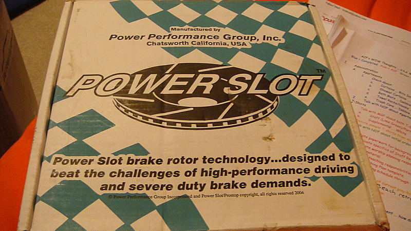

Check it out! My rotors and brake pads came today. Getting them installed first thing tomorrow morning!

ohhhhhhh niceeeeeeee!!!!!!!
one question;
I heard having slots that extends to the very outer edge of the disc puts a lot more pressure to the disc to crack. is it true?
