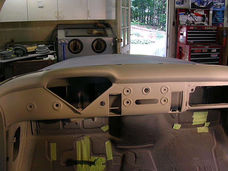

Clear HAS to go over the base coat, assuming that is the type of paint the body shop used. To get the different degrees of gloss there are additives mixed with the clear to achieve the finish, flat, semi, matte, desired.
I flattened the clear in the interior of my '56 Chevy truck to give it the look of leather.
Attached Thumbnails Aero Kit Question!-56interiorpaint014.jpg   Aero Kit Question!-56interiorpaint008.jpg
