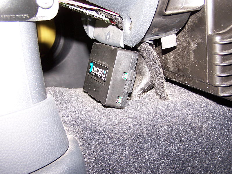

Old Jul 10, 2009 | 01:55 PM
  #1070
LeeL's Avatar
LeeL
Joined: Jun 2003
Posts: 703
From: Morrisville, NC
Originally Posted by o-ron
A few questions (which I think have been answered, but are still a bit unclear to me..)
1) It *does* charge new iPhone 3G / 3G S devices properly, correct?
If you buy a unit now, it will have it. Some time around the end of 2008, they changed over to a unit that will charge the newer devices. (look around in this thread for more info). You can get a replacement interface cable for older DICE units that will also charge the 5v stuff. Mine from late last year charges my iPhone 3g fine.
2) Does SMART mode work with the iPhone and does it let me control the phone from BOTH the head unit and the phone's display without having to reset DIP switches?
I am not 100% sure, but I do not think you can use the iPod controls as well as have full control and display on the Head Unit. Though I might be wrong. Mine will not do it though. You can access all the rest of the phone, but I get "Interface Connected" on the phoine screen when I try to use iPod mode.
3) If I do a trunk install, can the DICE unit be placed in the rear hatch (where the cd changer would go) and then just run an ipod cable up to the front of the car (in my case, i'd like to put it inside my armrest)? Or would I be better off with the radio install kit instead?
The trunk kit actually comes with a 10 or 12 foot cable that runs from the trunk connection area to the front of the car. This plugs into the DICE box and then the iPod cable plugs into the DICE box. The iPod connection cables are only 3 or so feet long, so the DICE box will need to be installed up front regardless. I put mine behind the piece right under the console. I took a crap load of pictures and will try to do a write up at some point. See below for one showing it before I put the pice back and after, including the way I let the wire run under the center console.
4) Are there still reliability issues with the new SILVERLINE PRO version? I've heard a lot of mixed reviews.. (slow, buggy, randomly stops working, etc...) *
*specifically with OS 3.0 for iPhone (which is what I have - on a 1st gen iphone)
I'm trying to decide between this kit and the simpler Kensington LiquidAUX which would work with my existing aux port, be simpler to install, and cheaper.
Thanks!
I have some of these issues on occaision, but it is fixed with a cycle through the inputs. I have had more problems with the Album and Artist modes since 3.0, which I posted about earlier, but I have not played with it enough lately to know for sure if it is the normal glitchiness with these units or something new.
Attached Thumbnails [eas] Official DICE iPod integration kit Q/A thread-100_3681.jpg   [eas] Official DICE iPod integration kit Q/A thread-100_3701.jpg
