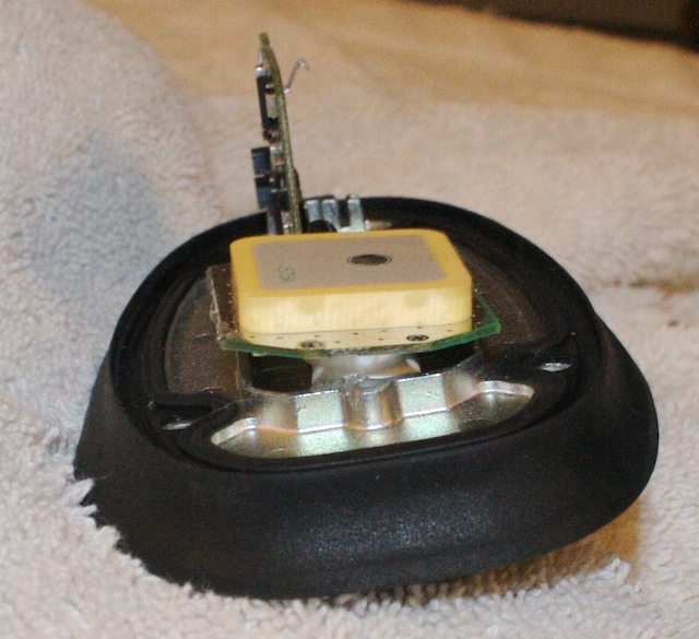

Those Sirf chipsets really rock.
I just finished stuffing a Gilsson antenna into the stock antenna housing. Worked like a charm. Hopefully the hot glue I used will hold up, but if not, I'll use some epoxy. The antenna has an MCX connector, and I was able to get it through the antenna housing opening without having to cut or unsolder anything. Full write-up to follow.

Update to the update: this works well. It seems slightly less enthusiastic about getting a 3D differential lock, but it was seeing 10 strong satellites this morning, and trying to lock on an 11th when I switched the screen.
