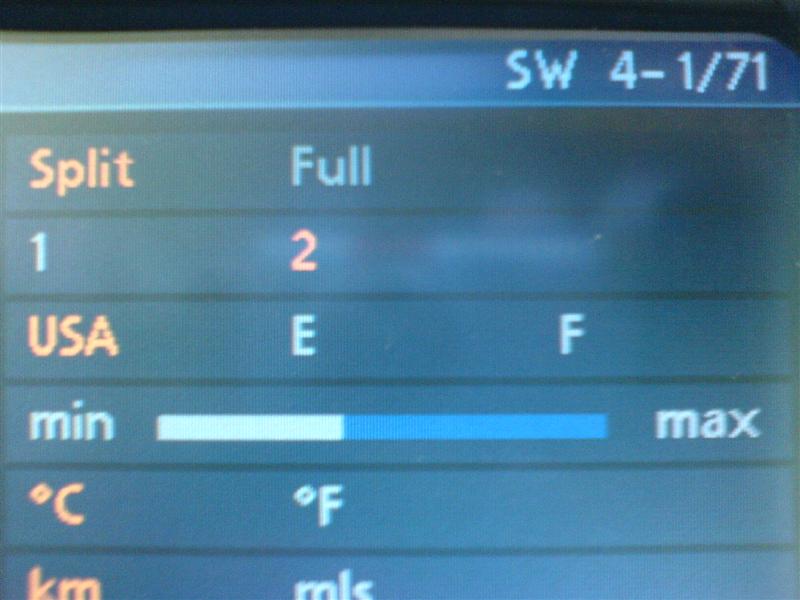

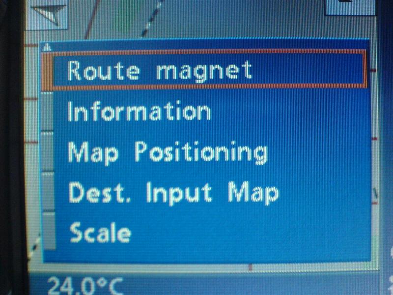

After waiting for more than a month, my Navigation is finally replaced today. Everything is working fine again.
One thing I'd like to mention to you all is that I guess I have a more current software version that v27. I've noticed that the version in my Nav. now is SW 4-1/71 (I remember that the v27 was SW 4-1/70 before) and I have the Route Magnet in the menu now. I'm still trying to figure out how it works but all I know is that you cannot enter an address as the magnet.
Anyway, I'm all happy with the Nav. working again.......
